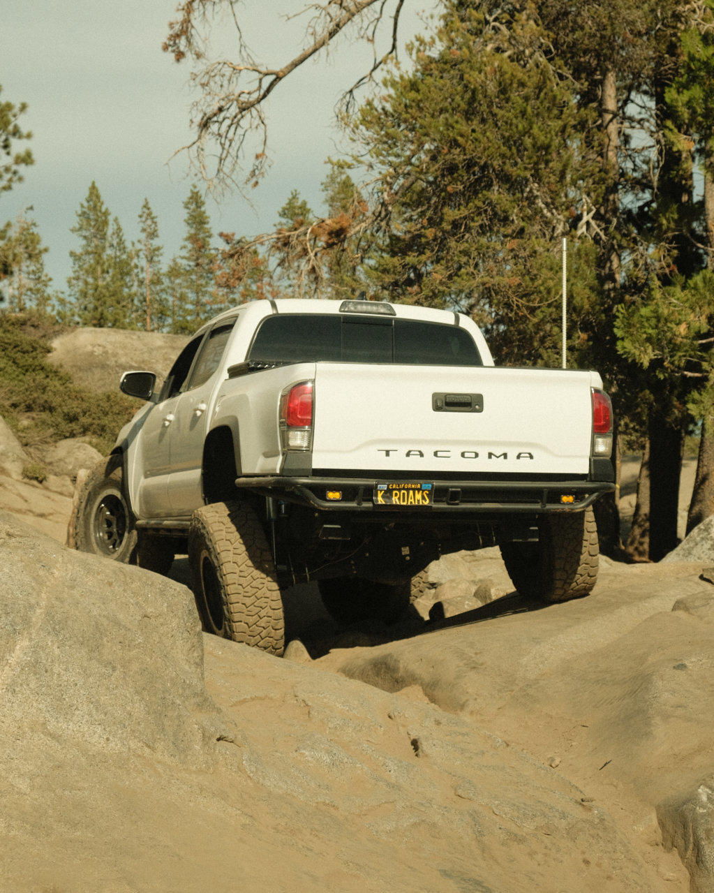

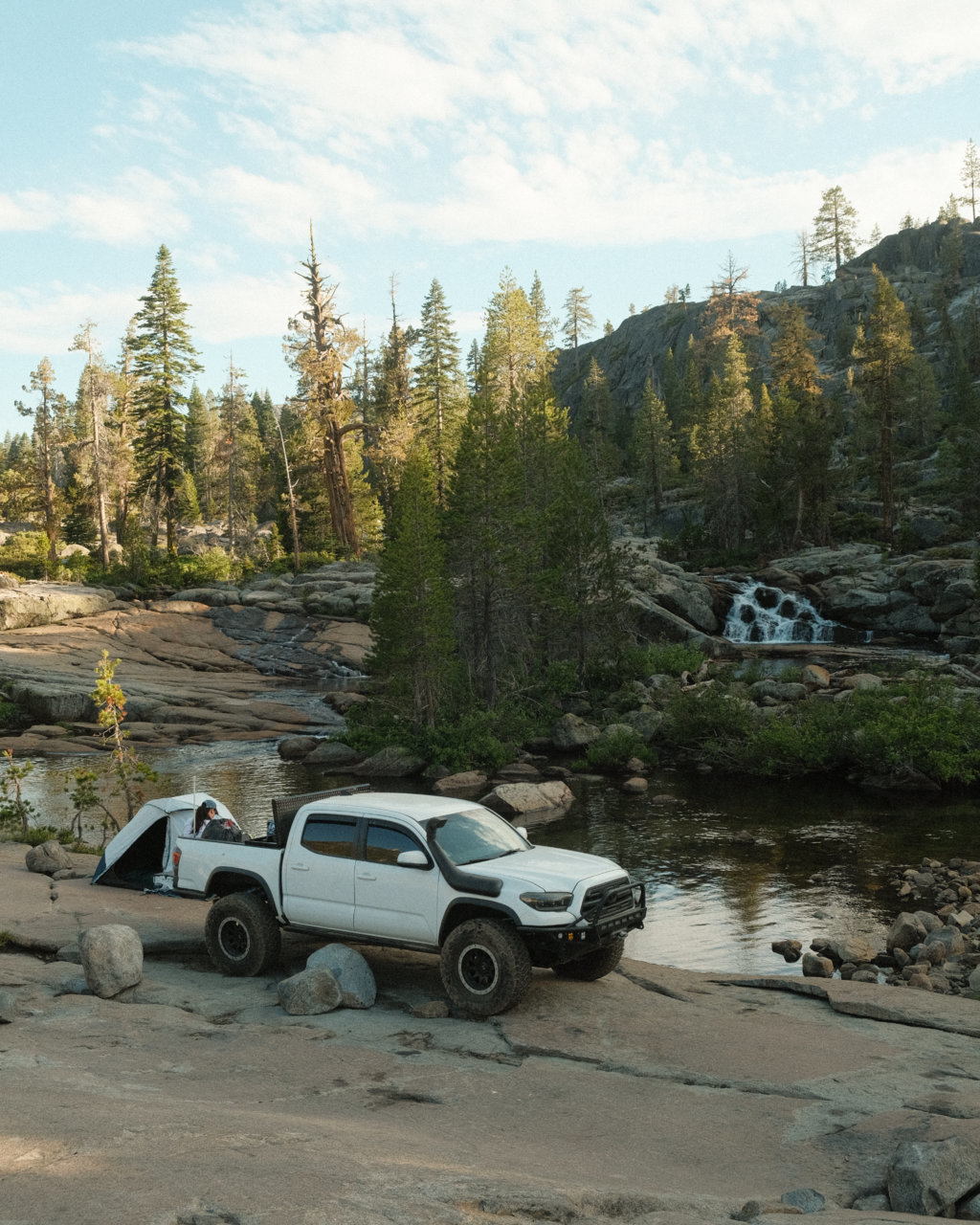

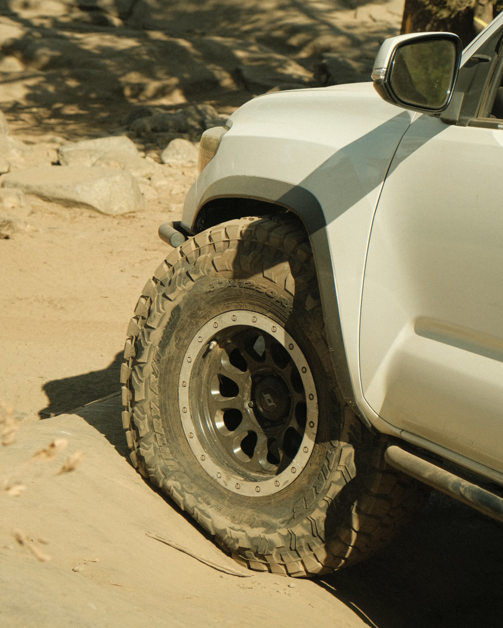

    Rack update!
    Just knocked the Rubicon trail off my bucket list, I was definitely the only IFS rig we saw out there for 3 days, truck did great, that trail is no joke, anyway tundra rack on 37s double locked going strong!

    That second photo... wow.
    The framing, the way the tire size is perfectly rotated into view, the bottom deflection on the rock... damn. Nicely done!
