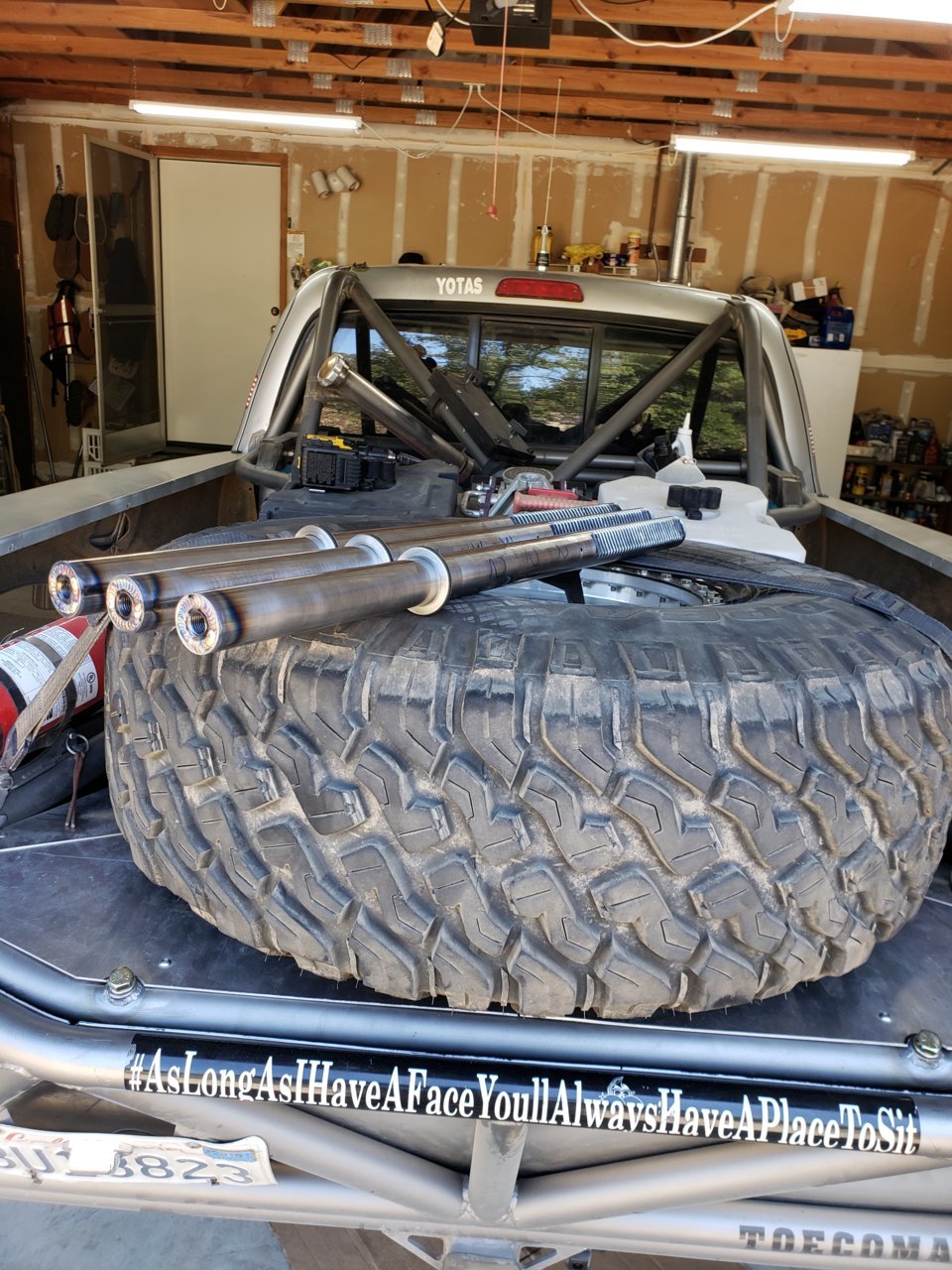

    Just an update for the three guys on the list...got all the racks torn down while at work...I'll be home in a couple days so I can clean em all up and start machining the parts...

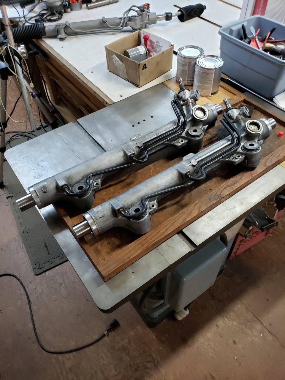

    2 done!... gunna 3d print a lil plug setup for the ports...since earplugs seem kinda hokey

    #76
    welderf15
    welderf15 Well-Known Member
    Nov 8, 2011
    #66687
    135
    Bryan
    Clovis, CA
    2011 DCSB
    Nice work Trav. Very interested in this. Please keep us posted on your progress
