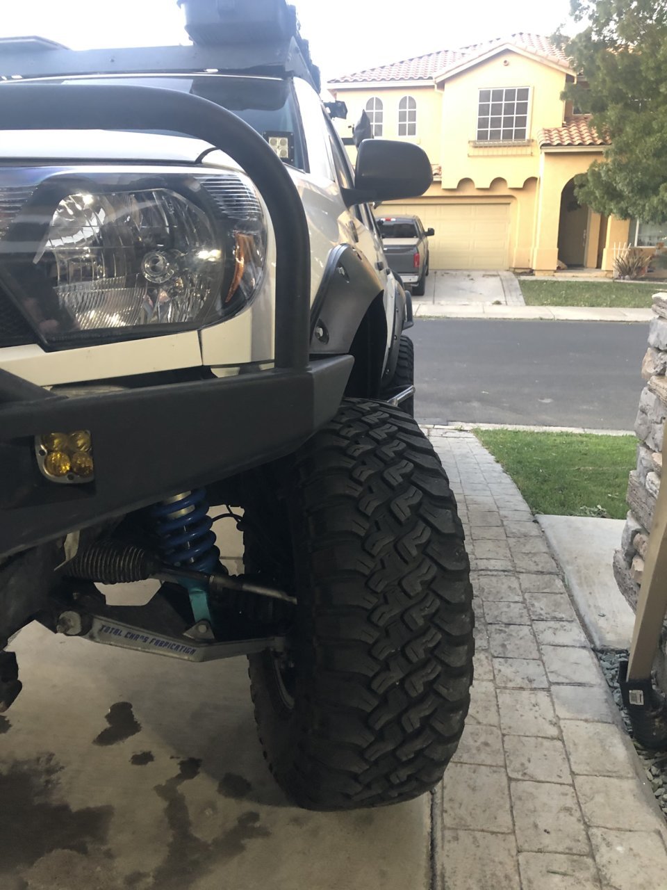

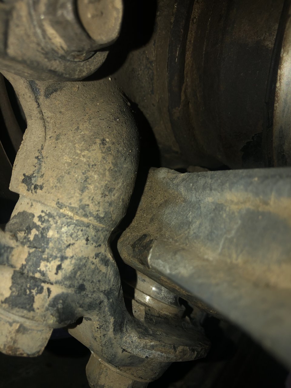

    Update. I still have to get this thing aligned and take it on some trails but one more thing I noticed this weekend driving the truck around is that it doesnt turn as sharp at full lock. After checking my LCAs my lower spindle piece no longer contacts the arm at full lock. I dont believe this is an issue as its not far off but I believe it is worth noting. Im still enjoying the powerful rack. My truck is so much easier to drive on the road. I can turn the tires at a dead stop no problem.

    Since Nick noticed this I went and took some measurements to make sure the racks are machined down to the stock length and they are...just never measured the stroke length and the stroke is a little less than what a stock rack can move. But as you can see and decide for yourself if you can live with a little bigger turning radius.
