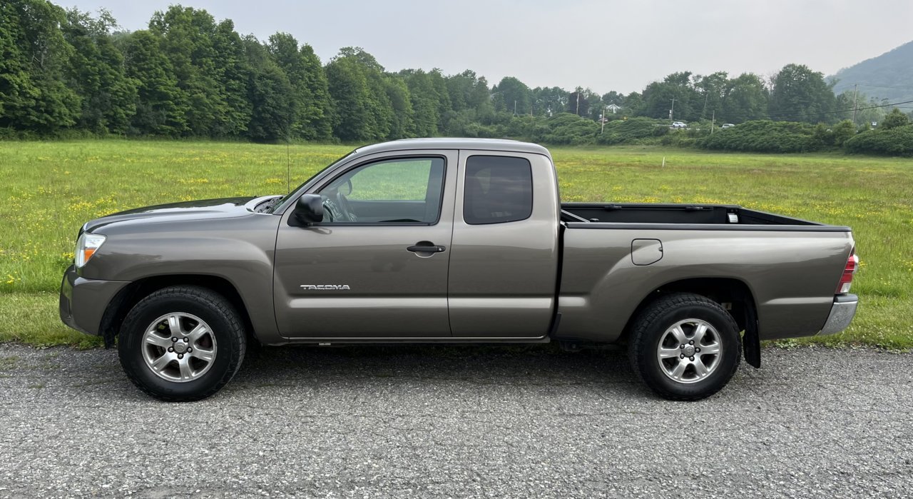

    My 2013 with 16" Highlander wheels and 235/70R16 tires, which are dimensionally almost identical to 235/75R15.
    No clearance problems with this setup

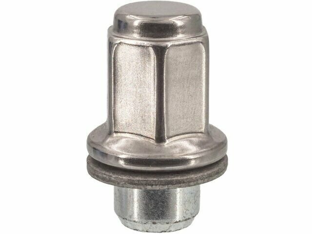

    First you'll need lug nuts like these. Thread M12x1.5. The acorn shaped lug nuts for the steel wheels are incompatible. Plenty of sets online for $30 - $40. I don't recall where I got mine.
    As far as TPMS goes I can't help you. I run these wheels without them and ignore the dash light. I'm thinking of making a TPMS pipe bomb but never seem to get around to it.

    Any chance you could post some picture from the front and rear so I can see the stance and how far it sticks out of the fenders (or not), Please :)?

    I looked in Craigslist and FB for Albuquerque and there are slim pickings right now. I forget the shear volume of stuff available in the NYC metro area isn't the norm nationwide.
    And those pics
