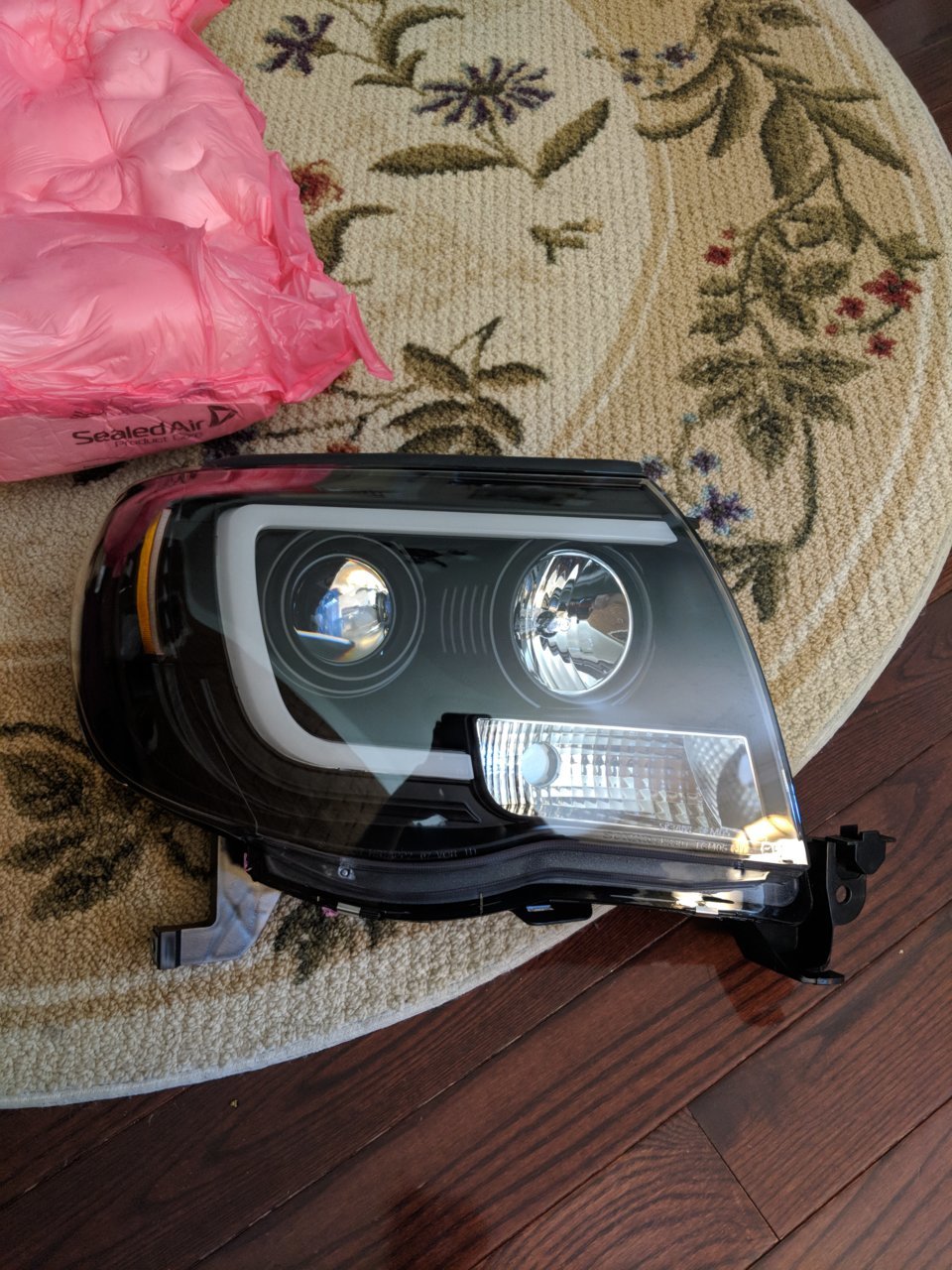

    Recent bought the 05-11 tacomabeast headlight with the drl light bar but my truck is an 09 and the drl light won't come on! Does anyone know how to fix this I saw a thread awhile back but can't seem to find it.IMG_20180707_120908.jpg

    Well Its not urgent, was just in a hurry...but don't sweat it I'm a total dumbass I fixed it

    Not with those headlights. They're made to use the parking light wiring to power the DRL bar and then you just leave the parking lights on all the time and flip it forward for the headlights when you need light. The parking lights will automatically turn on and off with the truck if you leave them in this position for the DRLs to work.
