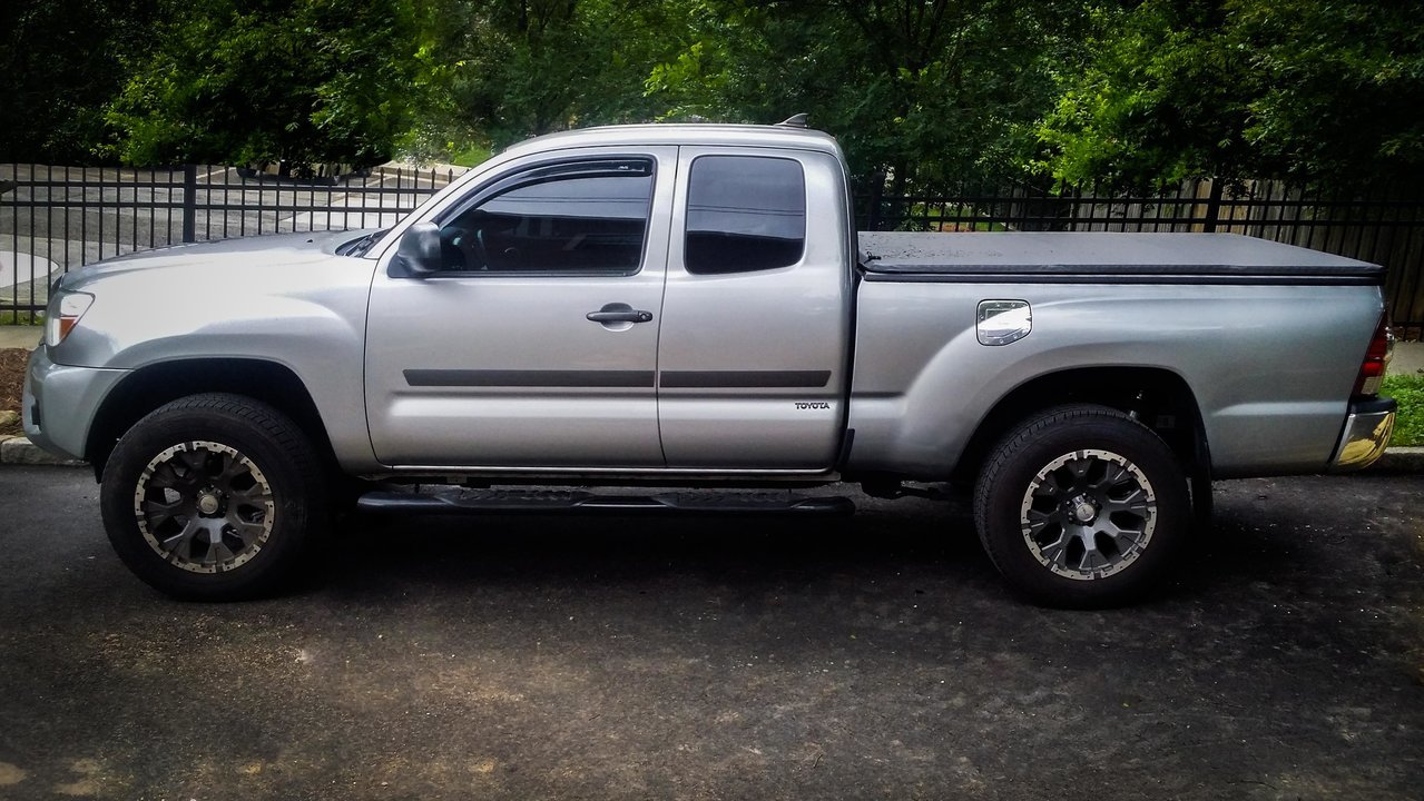

    This is what my truck looks like now...
