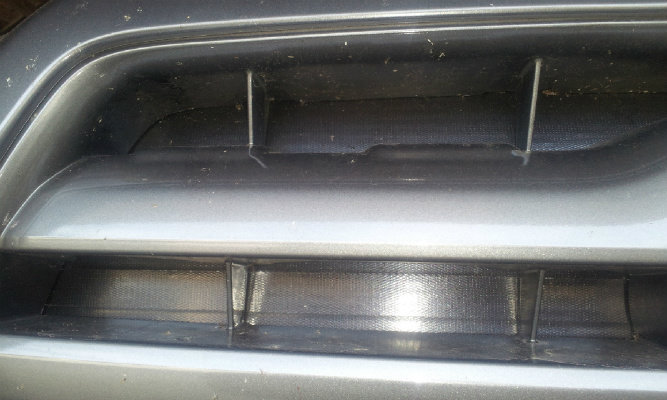

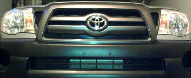

    The radiator is capable of removing enough heat to handle very high throttle (up a mountain) with a trailer (up to 6500#) in the summer with the AC dumping hot air onto it.
    I don't drive mountains, I don't pull a very heavy trailer, I don't live in the south, and I don't have an auto tranny that depends on cool air to keep its fluid from overheating (this part is important). Therefore I can push the air over the truck instead of thru the engine bay and under the truck where aerodynamics suck. The difference with the upper block was substantial. Before summer gas was introduced into the mix my average increased in the neighborhood of 1.7-1.8 mpg, essentially closing the gap to the auto tranny's mileage.
    Only downside is you gotta pay attention to water temp (ultragauge & its alarm for it is a winner here) and listen for the cooling fan. If the fan starts kicking up, it's too hot in there.
    We set a record with 87 degrees F in the month of March. The A/C was ice cold even with less airflow. Peak water temp was 194ºF going up a big hill. Fan clutch never needed to engage past its normal minimum level as far as I could tell.
    My lower grille has a partial block. Didn't see much difference with that in either mpg or water temp but it doesn't hurt. Upper made the difference. Love it or hate it, for my application it's a winner. Besides unless I point out that it's there no one is the wiser.

    If I had an automatic, bare minimum there would be a scangauge with tranny temp up at all times and an alarm if it supports it. Boiling tranny fluid is not a food thing.
    Another option could be doing the upper 1/2 of the upper grille. That should keep enough airflow and give a mild bump in mileage.
    On a related note, I made considerable effort to blow out the carbon and drove quite aggressively from the start of the tank and at 330 miles it's still reading 21.6 mpg. It definitely works.

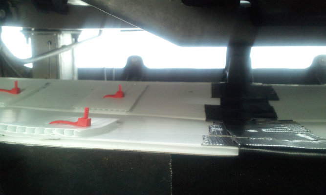

    Fortunately nothing one needs an engineering degree for. It ties to the hidden vertical supports of the stock grill. The sides of the grill have a layer of gorilla tape (not visible) that fills the holes you only notice when you put the block in.
    I just wish I could have found black coroplast just for aesthetics when the hood is open, but the satin black of the gorilla tape looks good enough from the front I probably would still use that on black c.p. anyways. Better than paint; the car wash won't phase it.
    Zipties are easy to cut and replace later if I need more air (for a trailer or whatever).
    edit: material is blank for-sale sign stuff at Home Depot for $5. One panel of 24x30 is sufficient to do the upper grille plus all those cross-layered supports I gave the zipties.
    22.7 mpg over 150 miles putzing around today on 87 octane. Finally ran and got diff oil to replace the factory stuff that has 38k on it.
