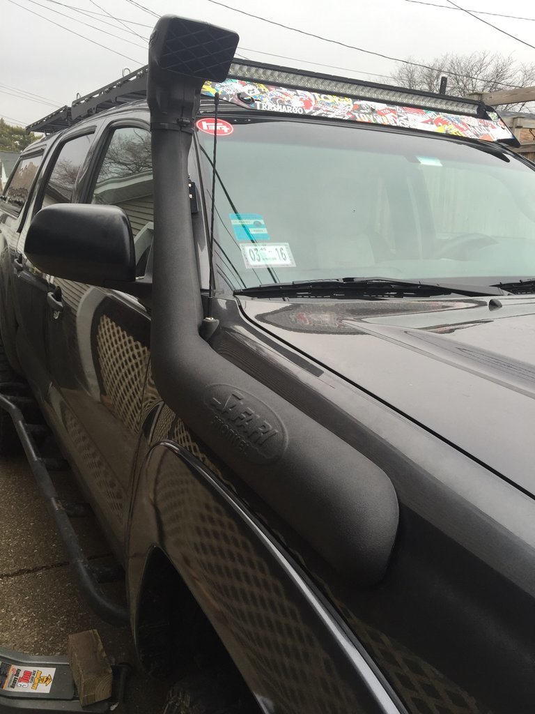

    There is this..

    That snorkel thing doesn't help much as you would think since your computer will go under long before the raised air intake.
