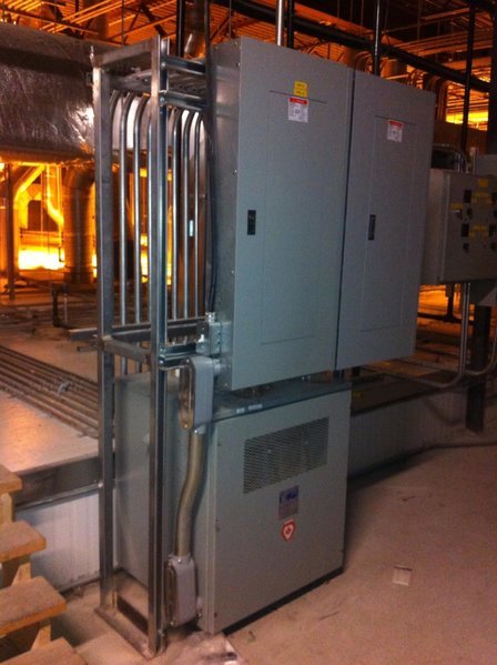

    Now one possibility that could work is electrical unistrut with spring nuts (strut nuts). Weld up a structure with strut for your adjustability points. You could use a tube structure and then strut where needed or the whole thing in strut.
    Here is a frame I made a few years back to mount a couple of panels where there were no walls to mount to. Initially there was only one panel but 4 months later we needed a mount for a second panel so the initial strut for the panel were replaced one at a time with longer strut and in ten minutes we had space for the second panel. Rectangular ends were welded and the rest is all assembled by spring nuts and bolts.
    Being adjustable makes a huge difference when you need a to add something later or you make a mistake in overlooking something. This could allow you to move your cross members forward toward the cab allowing you more height for loading at the rear.
