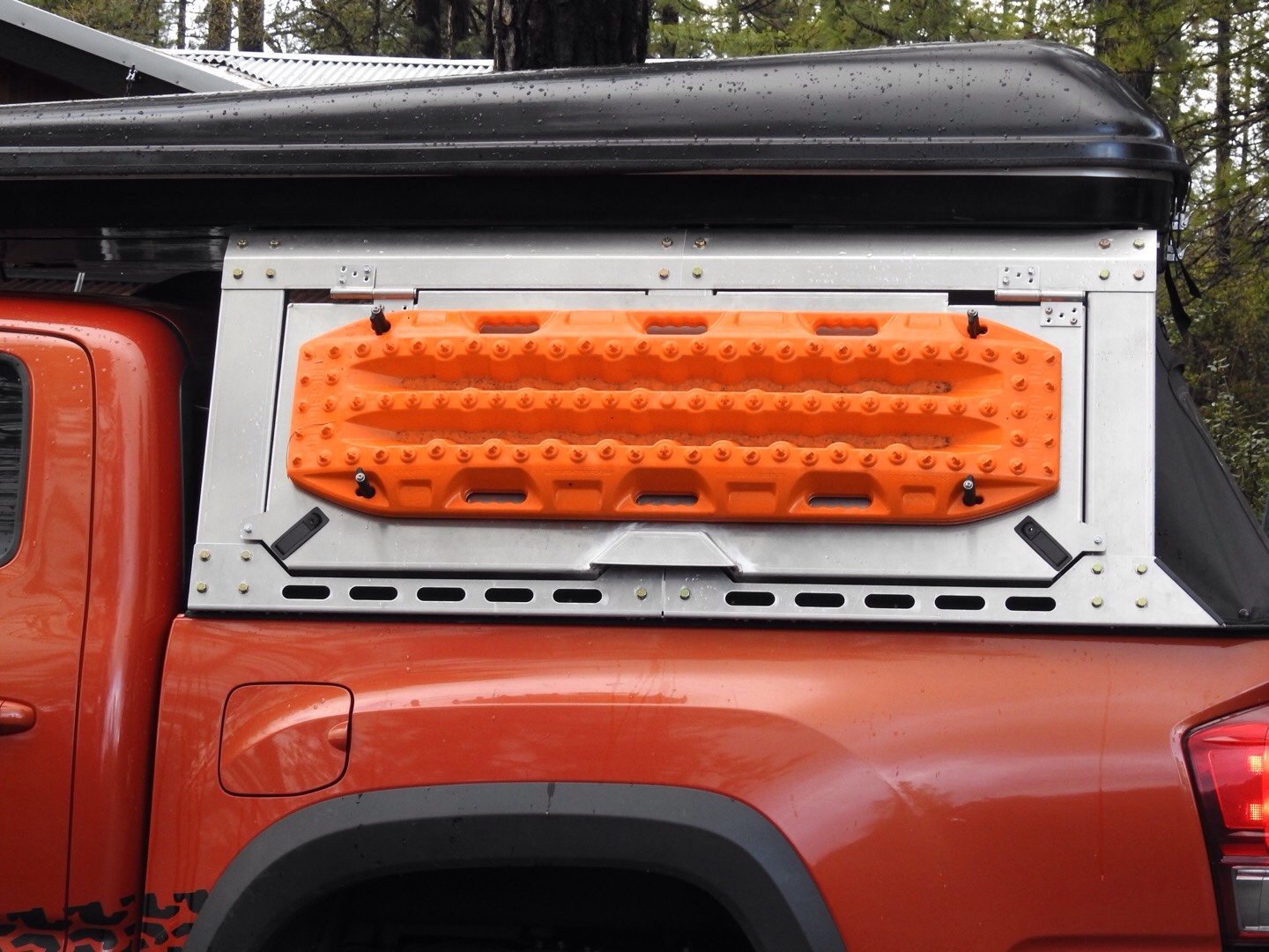

    Searched didn’t find if there’s a thread please let me know
    anyone know the best way to make or install modular mounting?
    here is the challenge:
    My bed rack has flat doors pre drilled for maxtrax and rotopax
    saw one guy had custom MOLLE
    Otherwise the idea is drill holes
    Here’s the issue with that
    -I don’t know if holes drilled in aluminum can be weld patched later
    -setups always change, improve, and holes are permanent
    -idk if there’s a universal hole size, or if all parts use different bolt thickness
    basically trying to figure out a way to make the doors able to mount anything, and be changeable
    without saying screw it and just drill a couple holes for one thing only to want to move it later
    best ideas I have so far:
    -drill a ton of holes like a grid
    -use existing holes to bolt on MOLLE panels, but that would protrude more reducing clearance. Or drill holes for that.
    -take the doors off find machine shop or somewhere to cut molle grid
    Might still be a challenge to use MOLLE.
    1. there seems to be no standard MOLLE. I see different designs.
    2. Some kits don’t bolt to MOLLE. For example Hi Lift has a mount that’s designed for flat surfaces. It uses bolts. Maybe use MOLLE nuts?

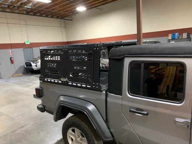

    this is one where I think they custom added mounting pattern on the doors somehow
  9. May 4, 2024 at 10:46 PM
    Kwikvette
    Feb 27, 2019
    #284735
    81,733
    Fresno County
    4 run, 2 don't
    Looks like a simple sheet with cutouts
    Add some hinges and a latch/catch and done

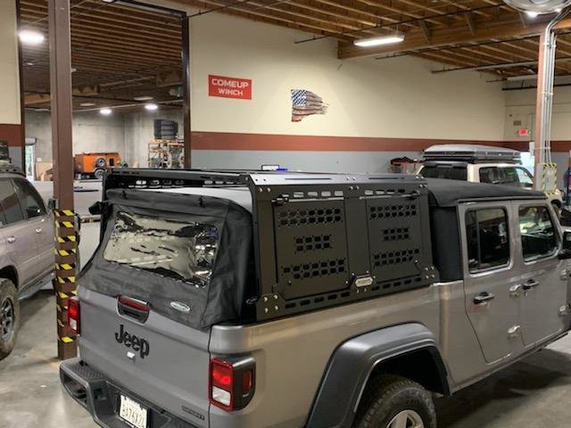

    might just reach out and ask them what pattern they used
    it comes with doors already have them
    hinges at top, latches at bottom
    like this:
