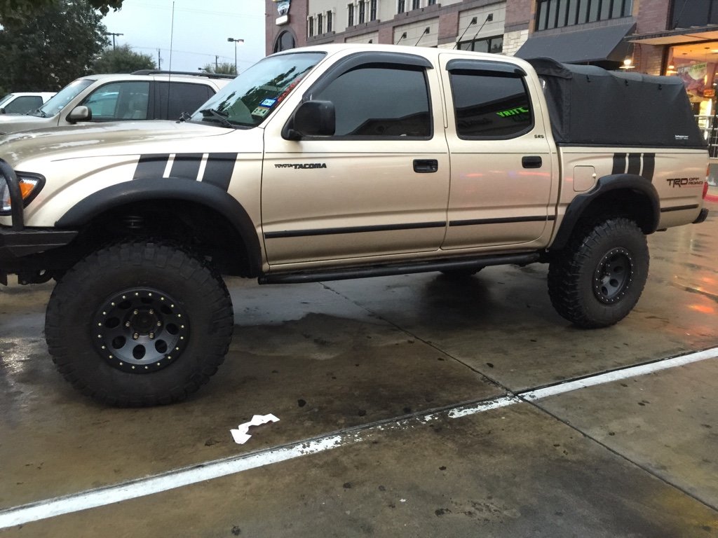

    3" lift EIBACH coils w/ 5100's front, OME/ Dakar leaf springs w/ toytec adjustable shackles at 1.5" and 5125's out back. 33x10.5x15 KM2's Relentless DIY steel bumper.
    New wheels on 11/14/2014
    Level 8 Tracker Pro (15" x 8.5")64ad7d300275dd61f54f912f4ac854c1_9c86d20249d326a327a0163e95e32fa7162b2c80.jpg
