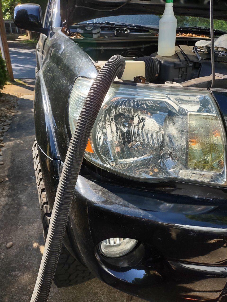

  10. May 6, 2023 at 2:21 PM
    #30
    Bad@Nicknames
    Bad@Nicknames Well-Known Member
    Oct 15, 2018
    #269503
    100
    Bruce
    Greenville SC
    2008 TRD Sport AC
    Bilstein 5100's set at 1.75 Gunmetal Ray 10's
    Had condensation for the first time this week. Shop vac in the bulb hole worked well for me today. I took the attachment off of the hose and it wedged in nicely. You can see the black hose if you zoom in. Condensation was gone in about an hour. Not sure where it came from yet so we'll see if it comes back. IMG_20230506_170125717_HDR.jpg
