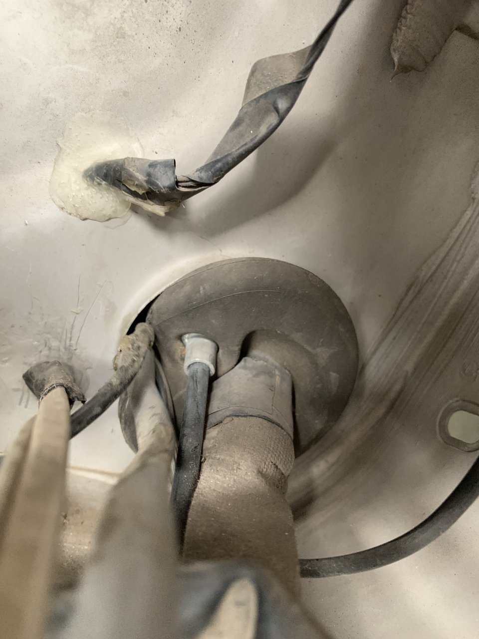

    Did you check the grommet on the firewall? Previous owner had Uhaul install a brake controller unit and they just ran the wires to the side of the grommet, instead of through it.
    Best Buy, who installed his alarm/remote start/door lock also just drilled through the firewall. Granted they put silicone around it but that could also be another point of entry if the silicone jobs sucks or it’s degrading.

    There's one more, throttle cable. That's the one that nearly destroyed mine.
    Madjik_Man[QUOTED] likes this.

    You know what...I did have to run some wires through there for my AFR gauge a little over a year ago. I wouldn't be surprised if that's the culprit
