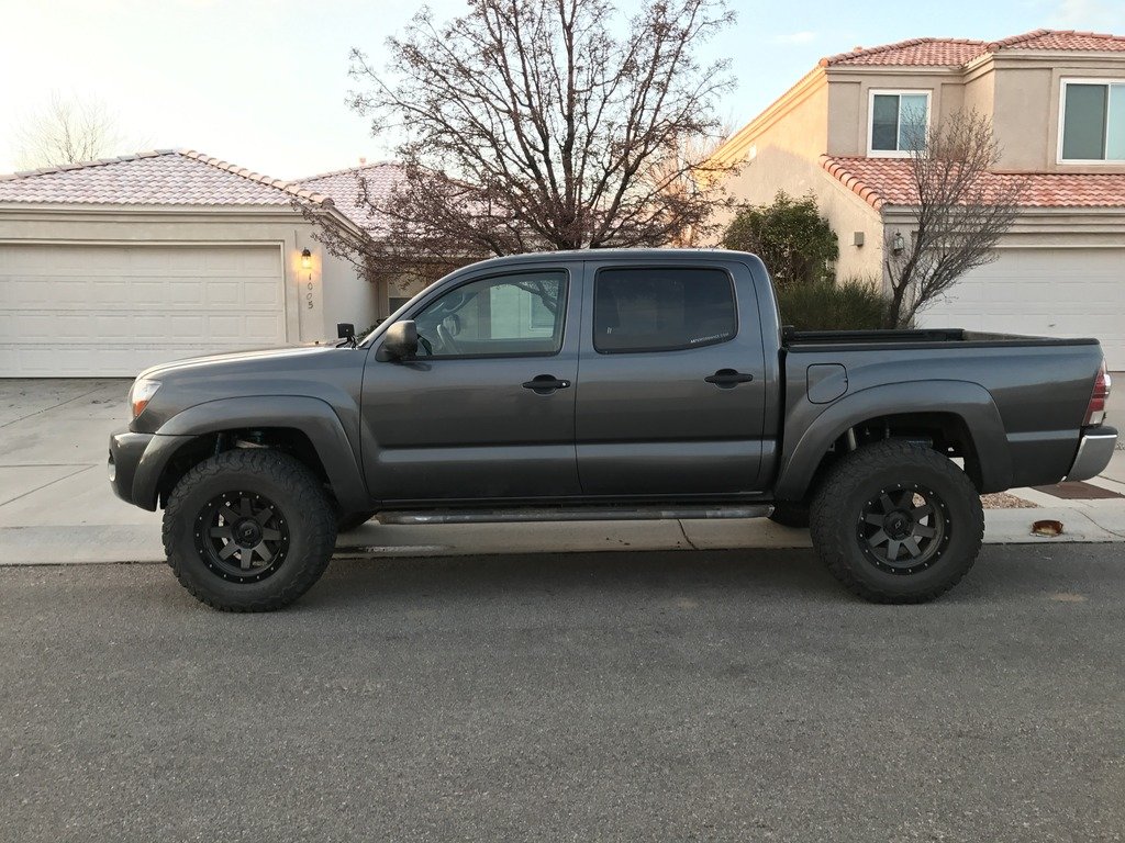

    Update! Got all the stuff under the fenders done. Still need to build the cross bar for the rear shock mounts. I can already tell the rear shocks need a little tuning and after talking a bit with @jberry813 I think we got this all figured out, faster rebound is needed! But so far I am really liking it and the potential is huge!

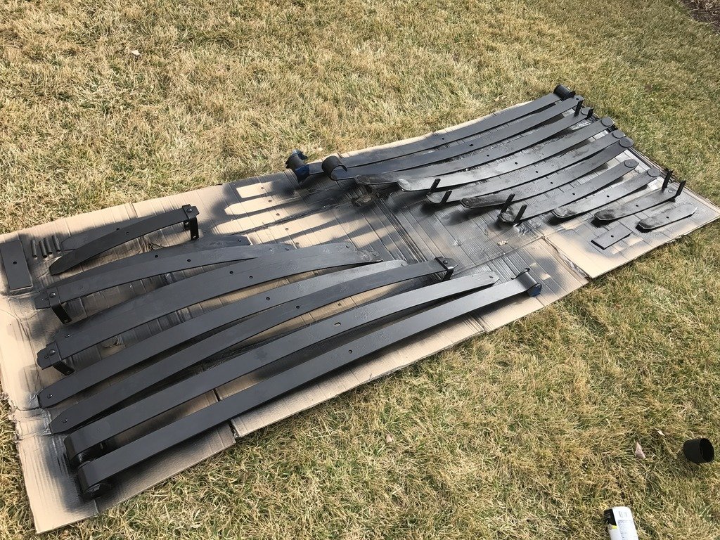

    For those who want to know what a deaver J66 pack looks like in pieces, here you go!
    F0712958-4AC1-4E18-B39C-D51C291B2B86_zps_d94ab0942fb277c89fe15cc91ae2644d35ed49f7.jpg

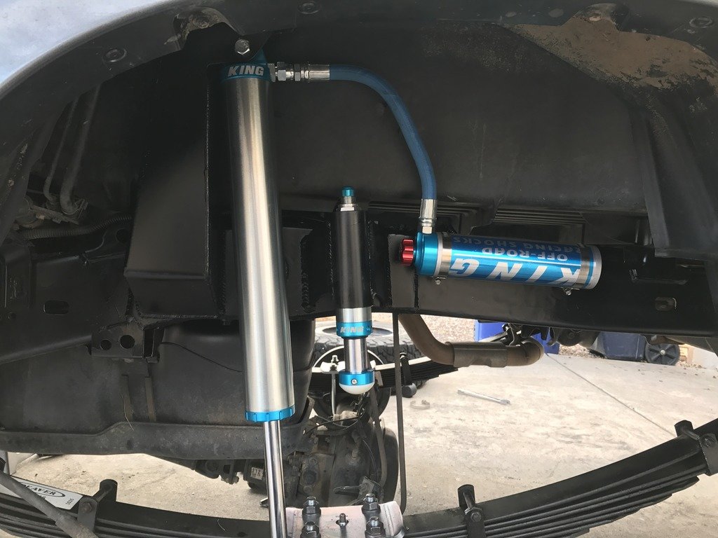

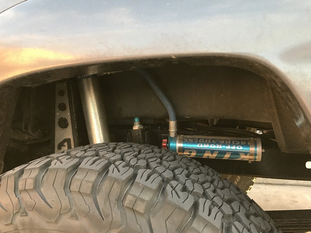

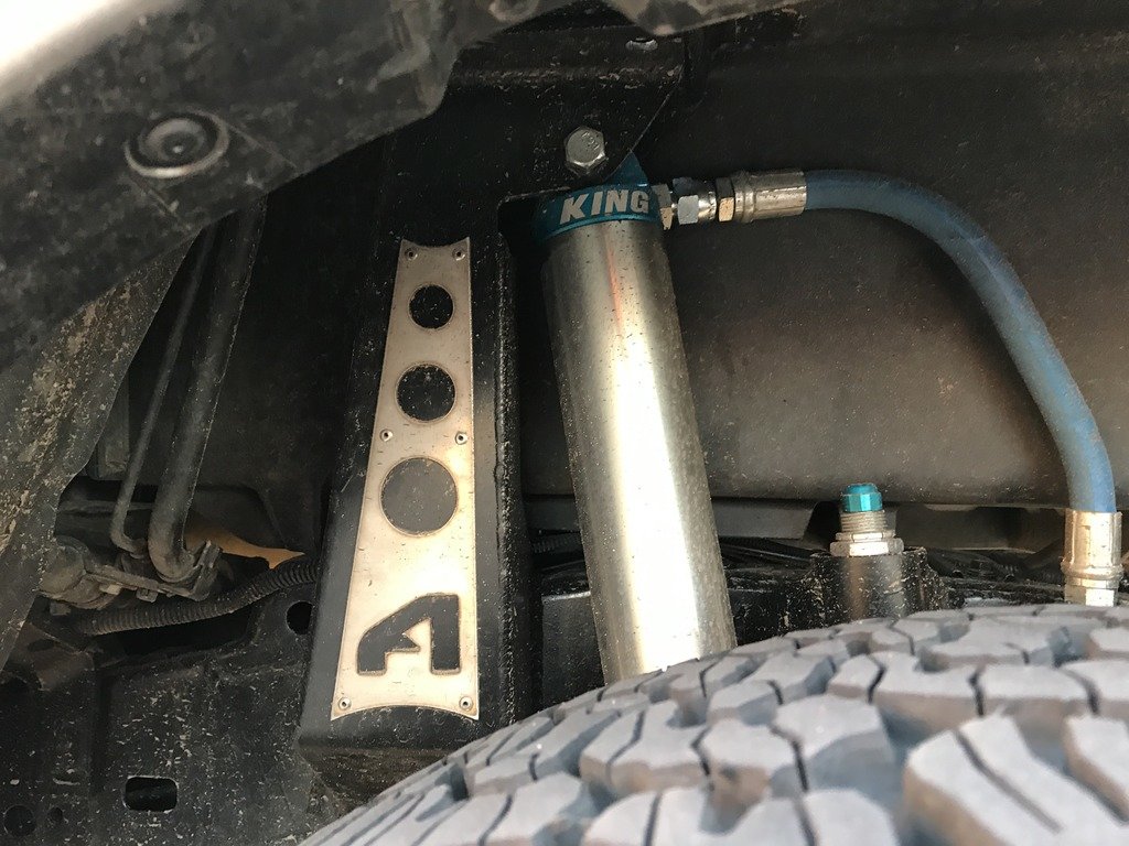

    And here are some final pics under the fender.
    09431066-CE03-4FE1-8DE8-6ACBE4E03219_zps_0b4d2d20b26fd9cb3674d635f08c0ed52ccbbbe6.jpg
    A30DB492-291C-4526-A647-5B7BCCADD9A8_zps_08d51e021ebefcd86cec8b8018fbba6da9e43961.jpg
    5C13936C-76D2-4065-B864-E216FEDC23F4_zps_4991b8259441371335c6517ee852d4a1ede529f4.jpg

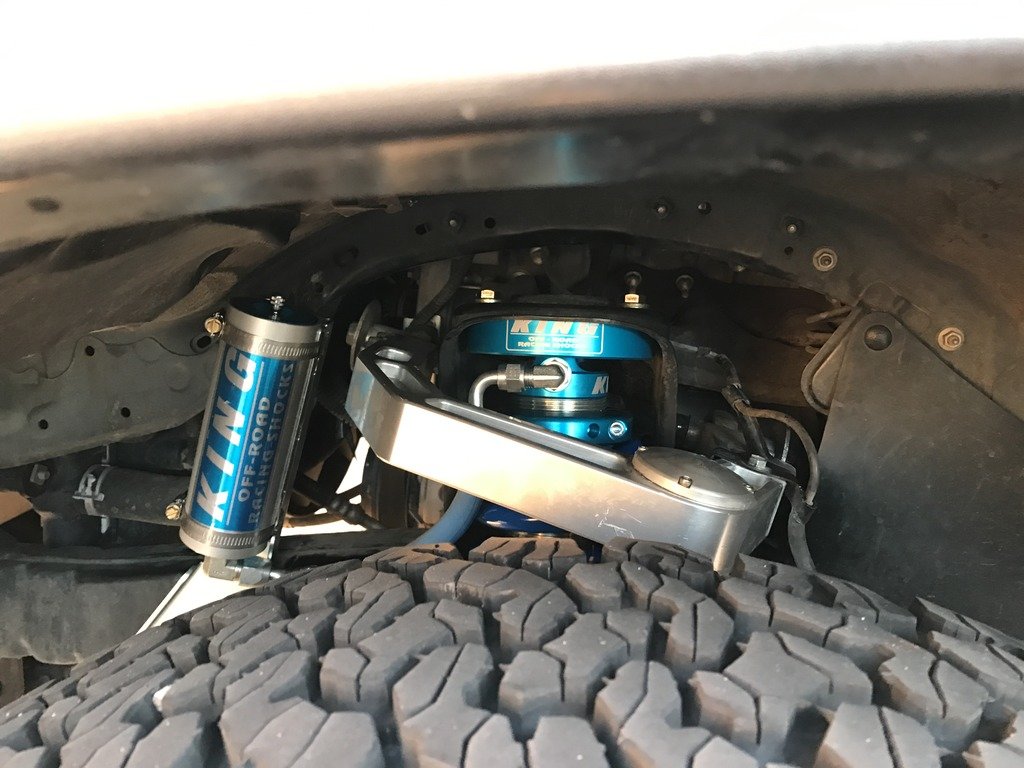

    Also started on the front suspension today. Was hoping to get moving on my bypass mounts. But... after getting the suspension apart and cycling everything, it was apparent that the project was a little to big for my current time line. I have a trip in 12 days and can't jump into a full front end rebuild right now. So I took advantage of where I was and trimmed the inner fender well area. Lots of plastic, bend and trimmed a pinch weld and did some further cab mount chopping from a poor job by the previous owner. Now at full compression I can go full steer in both directions with no rubbing! Got my new Kings installed and this thing is ready to party for a while!!!
    1ACE04A7-228D-4699-A53A-53BD4661C225_zps_22c55a8079bba64d070c34f7be4d9d3986e971f6.jpg
    And this is how it sits for now. I have a few hundred pounds that will got "permanently" mounted in the bed for most driving which will bring the ass down a little bit and give me the much needed weight it needs right now. She is a bit of a sleeper. Looks like a mall crawler that will pass you in the whoops!!!
    1F2B0877-5F2E-404E-B676-4705F913D04B_zps_7c19045159a3ad08f3e68e6ca74ba8cfcac302a6.jpg
