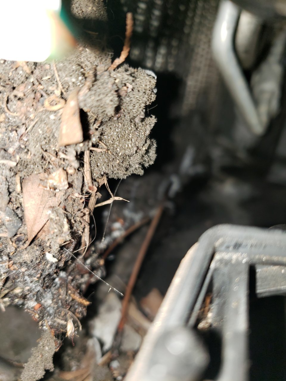

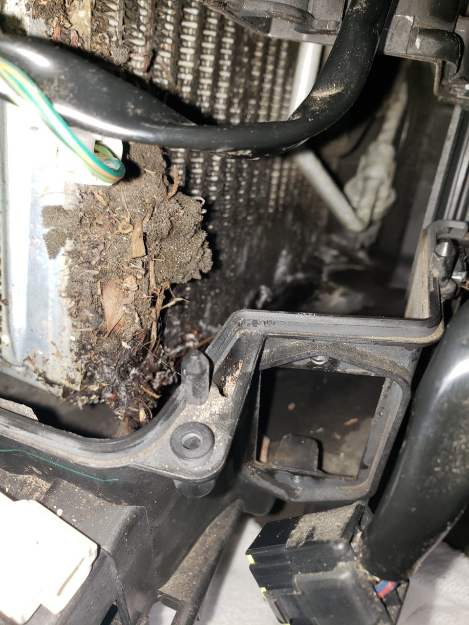

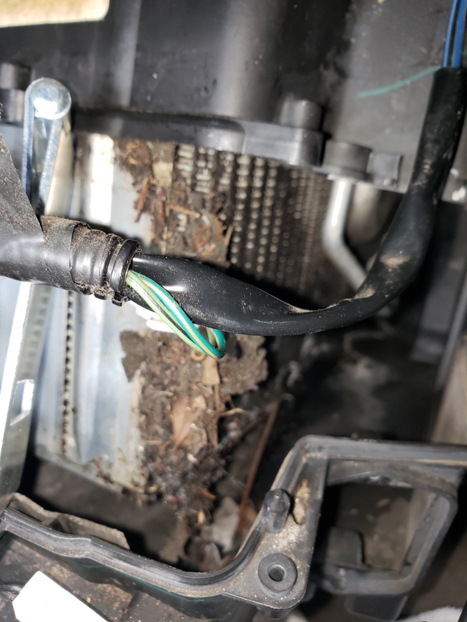

    I think the mold smell is gone. How could the previous owner think just hanging scented xmas trees from the mirror is the solution. You are breathing straight mold with pine tree fragrance to hide the smell. 2.jpg 22.jpg 222.jpg
