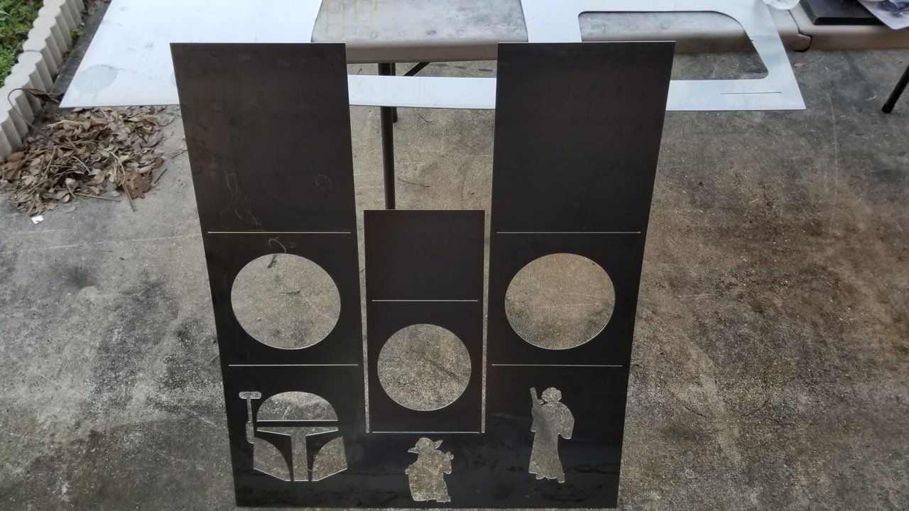

    today's project :) My princess kimmy was camera shy.20171229_114605.jpg 20171229_162348.jpg :)

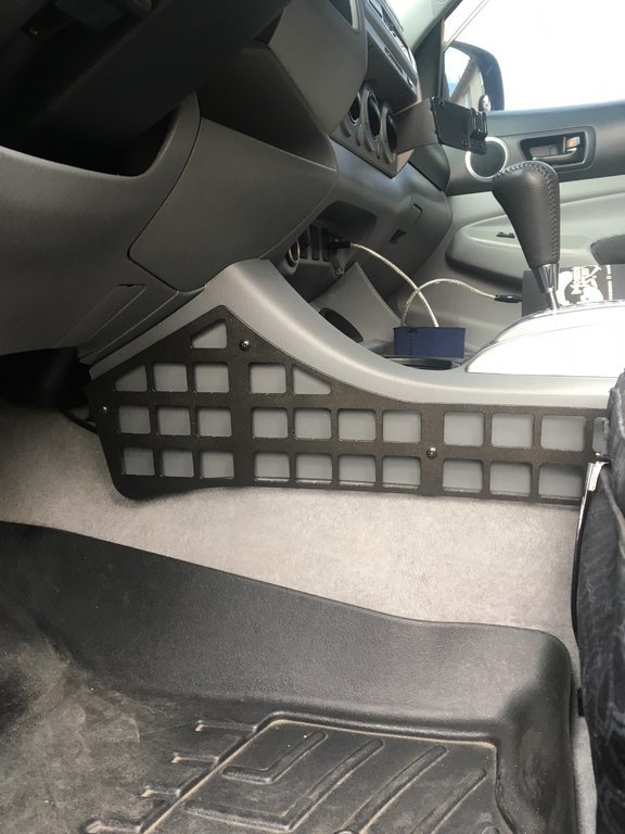

    Got them installed today. Went ahead and painted the screws and spacers ahead of time. @jc11taco89 had a good tip about running the screws through the holes prior to install. I ran a 10-24 tap into the holes just enough to get the threads started and it went real smooth. Thanks @Yo_Hec for a nice product.

    Nice install. Clean. No load her up and post more pix :)

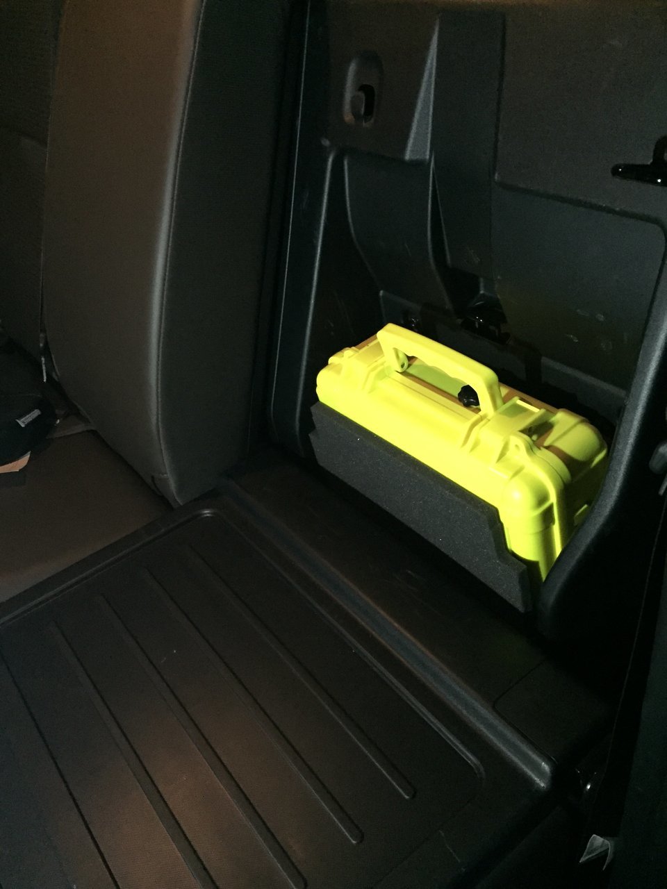

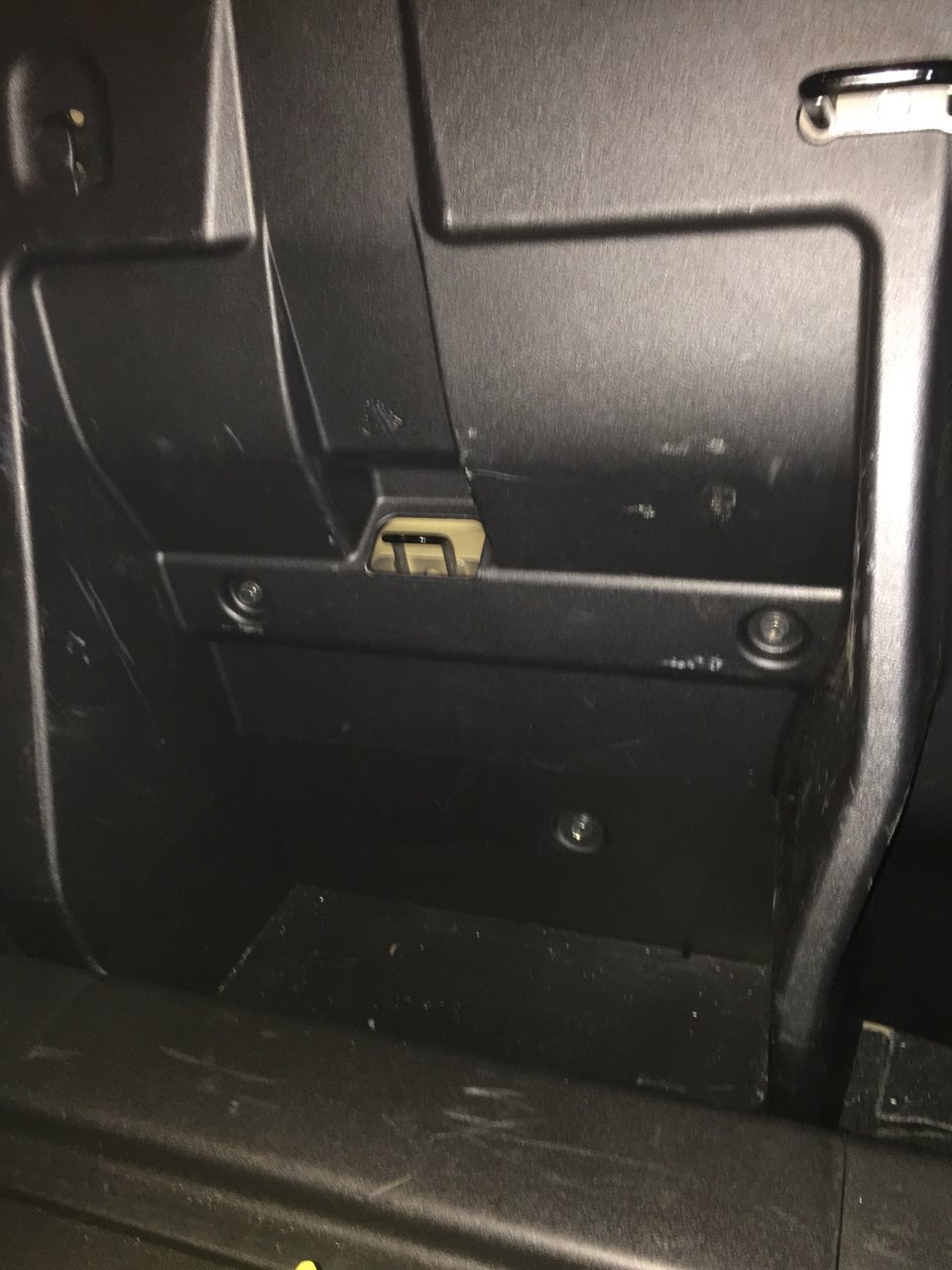

    @Yo_Hec - this is the cubbie area i was talking about behind the rear seat of a double cab.

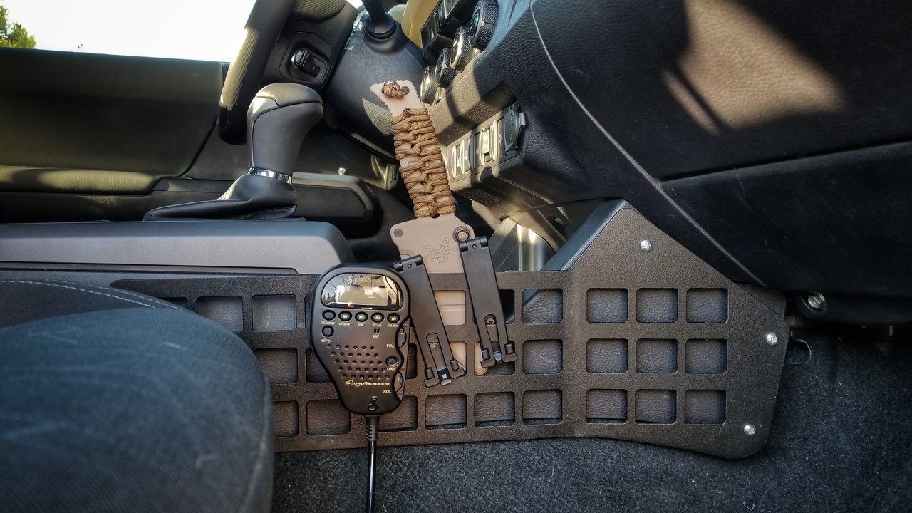

    If you want to mount an actual cb on the board you can. You can take your cb bracket and drill it on to the molle. or You can take a strip of metal, slide it behind the molle and screw the cb on to that if it's to wide. don't be afraid to drill into it if needed, it's pretty strong the metal.
