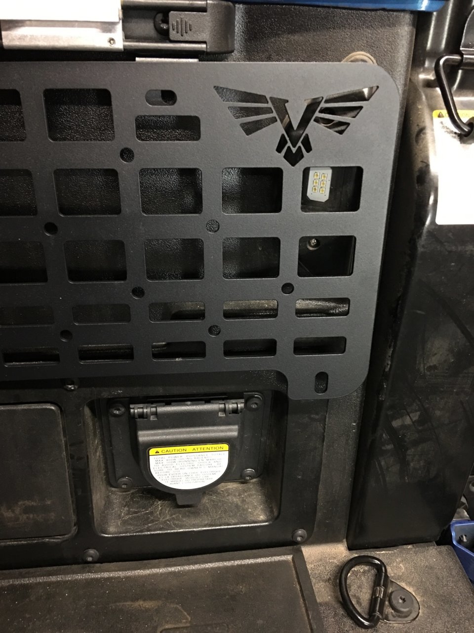

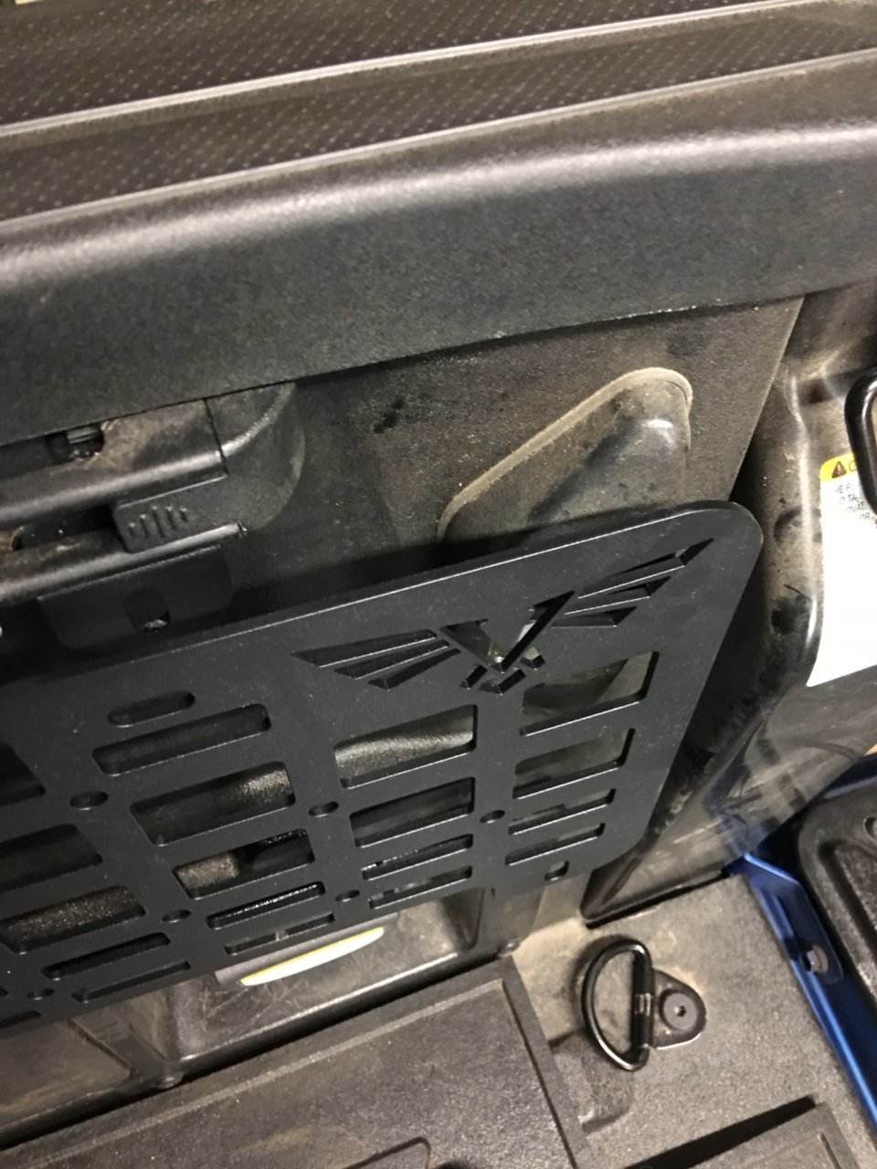

    Just a heads up for those with the factory LED bed lighting. The bed side Molle hits the LED light and you can not install the top or bottom bolts at the rear. Options appear to be 1) use longer bolts with spacers to keep the Molle off the LED light or 2) notch the Molle to fit around the light. I think I'll just notch it.
    Called Victory and they didn't know a thing about it. Chris was really nice and said he would pass it on to engineering team. And Chris even said there is nothing about this in their product literature, so I didn't miss something and order the wrong thing, lol.
    Pics below.

    I updated the site just now to reflect that issue. Sorry about the hassle! I totally forgot about the Toyota Light Kit when we wrote the description for these a couple of years ago.
    Just so I'm clear, this is still a dealer or customer installed option right? None are coming off the lot with these installed?

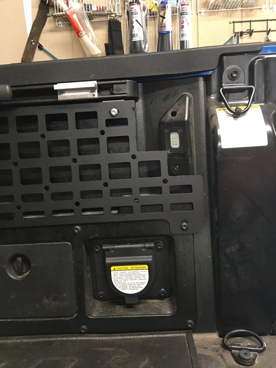

    I bought mine new from the dealer and it had the lights in the back. I checked the window sticker and it was a distributor installed option, so Gulf States Toyota in my case.
    Here is my solution notched, painted, and installed. Sits flush to the mounting surfaces now and doesn't touch the light. Sorry, had to cut out your logo :D

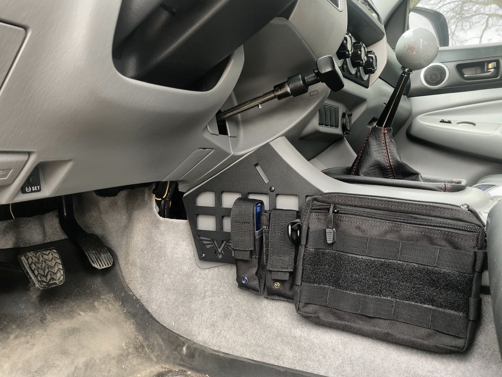

    Love these panels!!! Not only enhance the look of the lower center console, but also add a lot of function

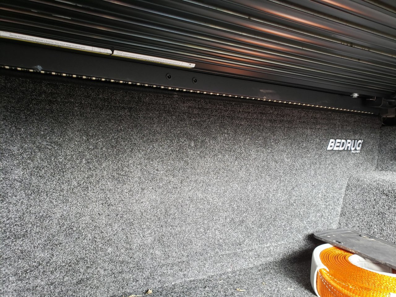

    Hello Victory! Sorry to revive an old thread, but do you think that Rear bed panel could be made to work with a Bedrug and Sentry cover? I'm trying to get a shovel and traction boards on that back bed wall. Thanks!!20210108_123805.jpg
