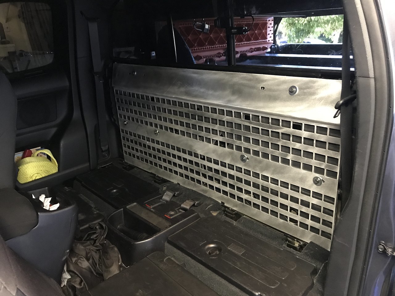

    How many third gen access cab owners have installed these?
    I just got mine installed (and I like it) but fitment left a lot to be desired.
    First there are some brackets that are for a child seat. There isn't a hole in the panel to accommodate these. So I had to cut them off (not a big deal but the panel should have a cutout for those).
    Second none of the bolt holes are even close. The upper bolt holes only had two that would fit. The rest weren't close. The smaller ones halfway down lined up. But to get any of them in I had to hog out the bolt holes (bigger than the head) and then use fender washers to make up the gap.
    Edit: Actually it looks like everyone has these issues.
    For sound deadner I just left the factory thing in there. Hopefully that does something. :)

    There have been issues with fitment of different and same generation access cabs. I can't tell why just yet. The double cabs never had these issues.

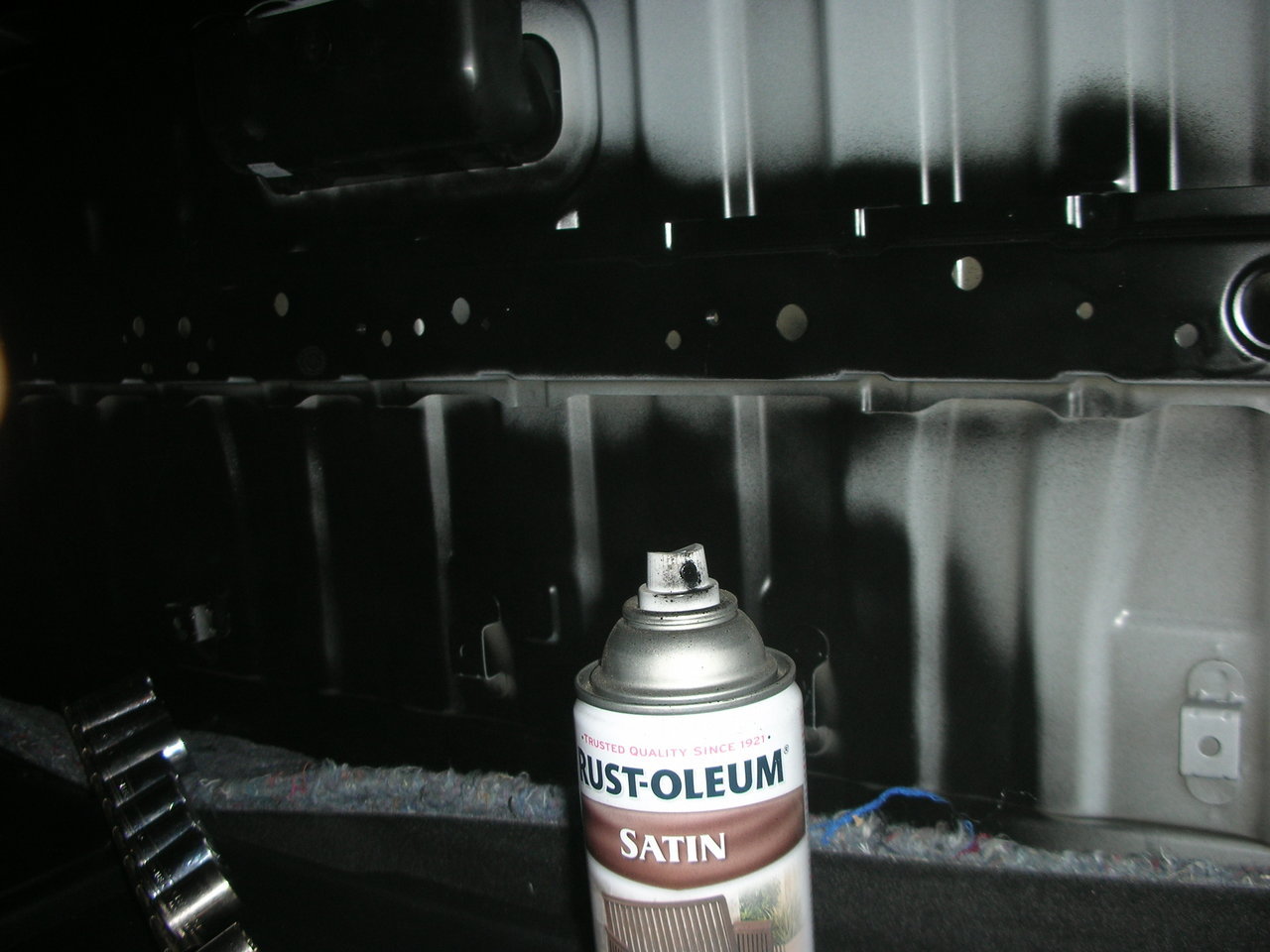

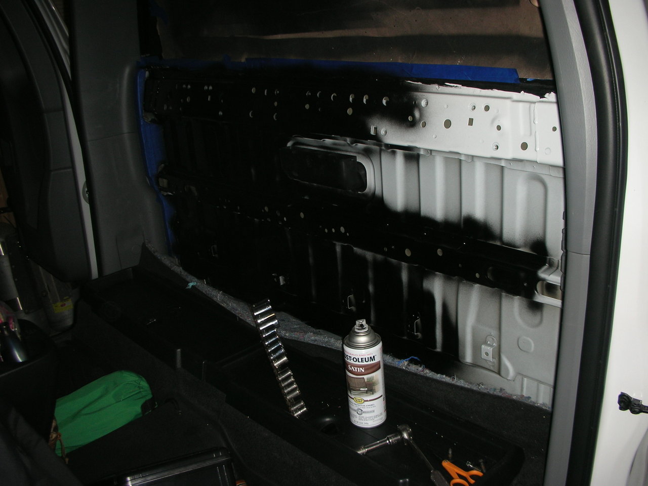

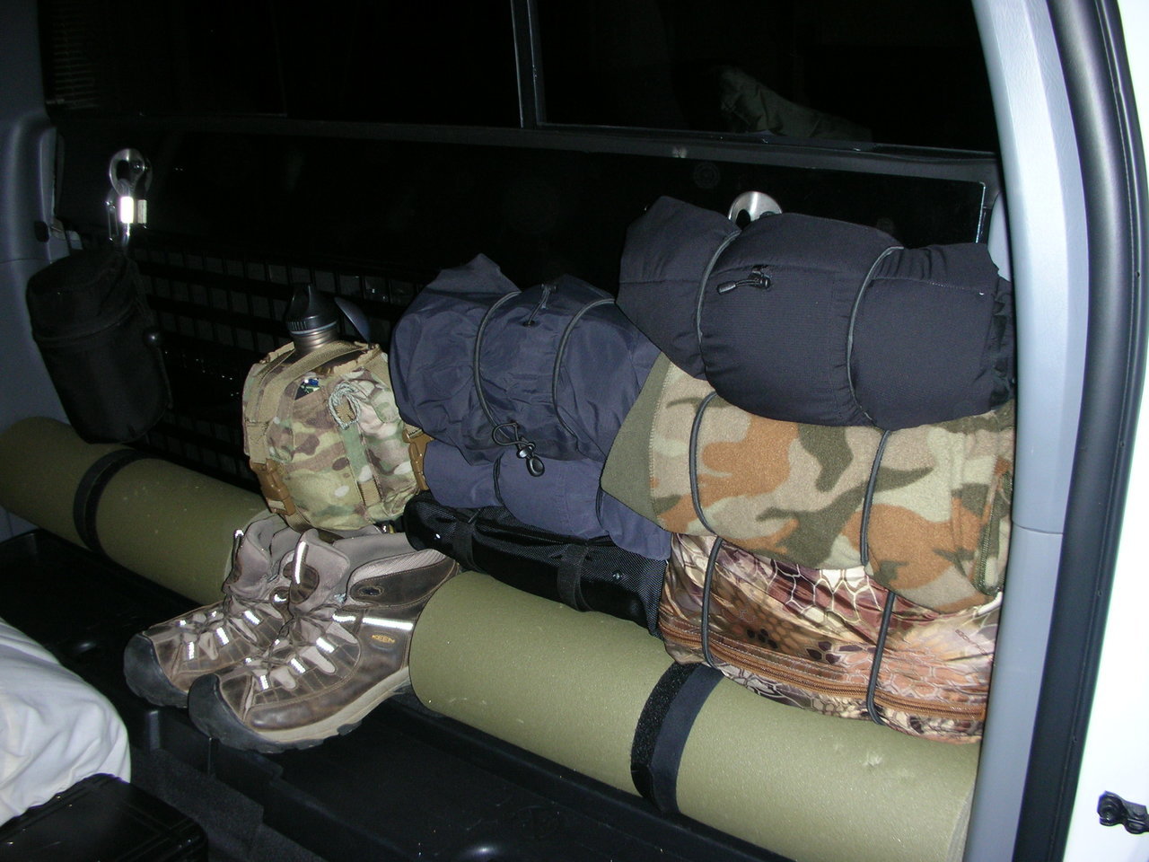

    So I didn't like my white truck...
    Cut up an old closed cell foam sleeping pad and Gorrilla taped it here and there, some bungie loops for now and viola!
