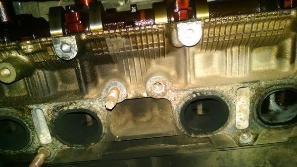

    One other thing I forgot to add, the whole point of my intentions to update this tonight...
    I borrowed a product that one of my friends bought, originally to test the head gasket on his 97 Land Cruiser. It is a UV chemical test kit. You run the engine, suck enough coolant out of the engine to create an air pocket in the top of the radiator, then suck the air up through a few one way valves and the chemical in the tubes changes color if there are exhaust gasses present in the cooling system which indicates a leak. They claim the test is very accurate and will indicate the slightest leak that will not need immediate attention. They even have a test where you breathe into your hand and suck that air out of your hand to show that the CO2 is reacting with the fluid to ensure it is not contaminated. I did that just to check and it worked, then changed to new fluid and proceeded to test my engine 4 times (twice for both the "recommended maintenance test" and the "severe issue test" which is recommended after a positive reading on the maintenance test.
    Of the 4 times I tried this, I could not get a Positive reading at all. I made sure to follow instructions exactly and tried twice on each test, both times with new fluid. Just wondering if anyone has an idea why that didn't work when I'm going through coolant like crazy. I add a 1/3 rd gallon every other day. My engine is running worse upon startup than it has in the past and my CEL came on last week which I have not had time to read the code on yet, but i would assume it is a misfire as it feels like I have 2 out of 4 cylinders firing on initial start up.
    I want to just buy the HG kit/ parts and go for it this weekend but I thought for sure with the symptoms I have that UView head gasket test kit would show a positive reading that my HG was fried. It threw me a curve ball that I don't know how to take. Is the kit bogus or just not as accurate as they claim it is? I'm also blowing white smoke after the engine runs for about a minute in the morning. The smoke has been less lately but that may be due to my mainly adding water lately instead of coolant/water mix or full strength coolant.
    On top of all this, my engine has always been a little louder than other 4 banger Tacoma's I've heard and known people to own. I think I have a loose valve or something. Originally I thought it was my timing chain, but now after listening to it closely under the hood it sounds like a top-end issue farther back in the head.
    1. Does this sound more like the head is cracked instead of HG?
    2. Are their any further diagnostics I can perform before taking the head off? I cant afford to get a new head at this point and need to consider all options.
    Thanks again for all the help/opinions and suggestions.

  18. Apr 30, 2015 at 5:38 AM

    Sorry about the latent reply. These new email notify's are only occasionally now. The chemical test are usually pretty accurate. So long as you performed the other head gasket and cooling system tests, hot or cold, and all those show up negative along with your chemical negative test, then you might not have a blown head gasket. A exterior leak in the system somewhere would puke the fluid out to make one think the engine is consuming the coolant.

    @Mod no worries, thanks for the reply. Could a cracked head have anything to do with the chemical test not working as it should? I'm going to start taking it apart today. I have seen the chemical test work for many people I can't understand why it wouldn't show some sort of leak for me. I want to do a leakdown test today before I tear it apart. Aside from that, can you recommend anything else to check the head/head gasket? The truck has been running progressively worse lately. I stopped driving it and out of necessity need to get it fixed soon. I plan to pull plugs first, examine them to see if there is anything I missed last time I pulled them, then do a leakdown test. If the leakdown is showing something wrong, I will pull the head this afternoon. I also wanted to do what @Stephen1231 mentioned and pull my manifolds to look at the deposits.

    I was going to suggest pulling the exhaust manifold and looking in those ports before yanking the head off the motor. But it looks like you are on the ball.
