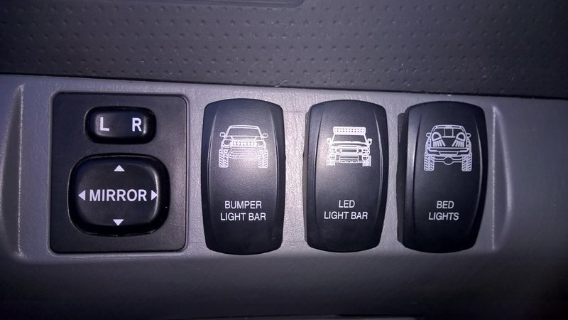

    Does anyone make a momentary switch that would fit in a blank space to the left of steering column? Or even in center console blank? Looking for an OEM looking switch for a trigger to a delay relay. Similar to fog light button but releases when not depressed - non-latching. Would prefer one with either one or two LEDs. 2015 DCSB

    58 Siesta - I've sent a message to AOB to see if I can get a LED Bed Lights switch cover on a momentary switch. Like the horn switch.
    kgarrett11 - Nice set up. I look at OTRATTW for over an hour last night and didn't see the momentary switches until I looked again tonight. Also have a message into them to see if they can supply a bed light rocker for the momentary switch
