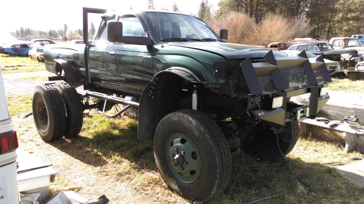

    2.5 ton Rockwell axles out of an m35a2 frame is a 1 1/4 Ton M880. Dodge 318 ci V8 torqflight 727 with a 2000 Tacoma with 390,000 miles on it that my wife bought brand new in 2001.

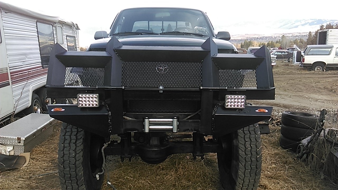

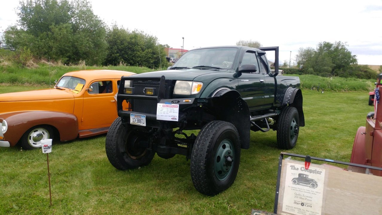

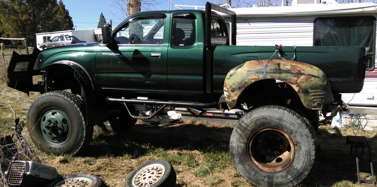

    IMAG0051.jpg IMAG0076.jpg IMAG0073_1.jpg 0527191153.jpg Hi everyone just looking to get some feedback on my Tacoma build .2.5 ton Rockwell axles 1 1/4 ton m880 frame small block.I know I Know WHY ? WELL BECAUSE I CAN . I see lots of high $ builds this whole project cost me just under 5k Thanks the truck also ha dual 3 in exhaust with super10 mufflers it's viciously mean.

    So it's gonna be a dodge pickup with a tacoma body on it?
    EDIT: NVM, wasn't a pic yet when i first saw post...

    Does it have working A/C and heat? Is is street legal (it has license plates so I’m guessing yes)? Does it have an automatic or manual transmission?
    That thing is seriously badass! Welcome to TW! :hattip::wave:

    Ya it's temporary I'm building fiberglass molds for front and rear fenders it will eventually be single wheel with 53 inch tires and yes it is street legal I am 101 in wide and just under 9 feet tall drives down the road great 65 70 mph no problem

    My stepdaughter rolled the truck it had almost 400k miles on it and the flexplate grenaded punched a hole in the block and snapped off the input shaft on the trans it was past the point of restoring

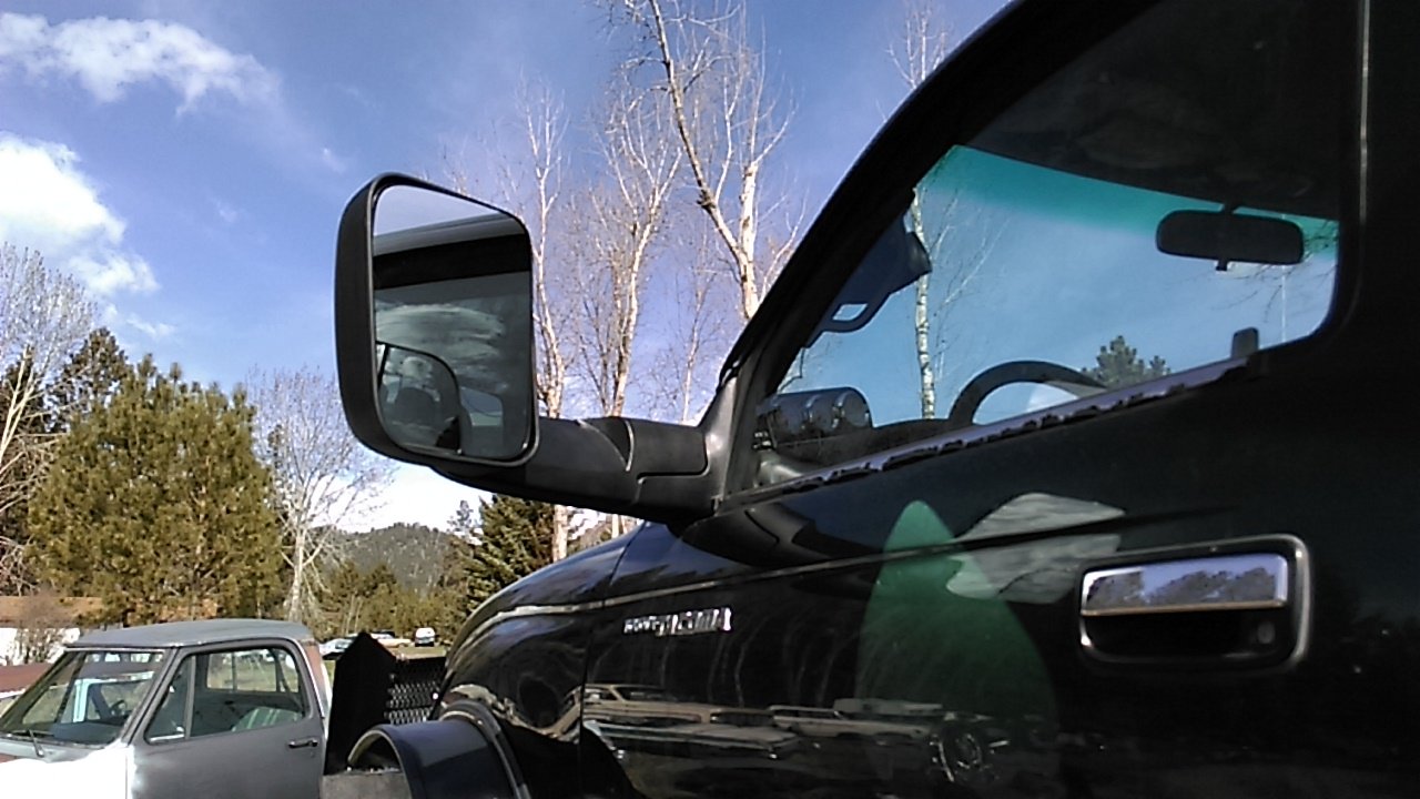

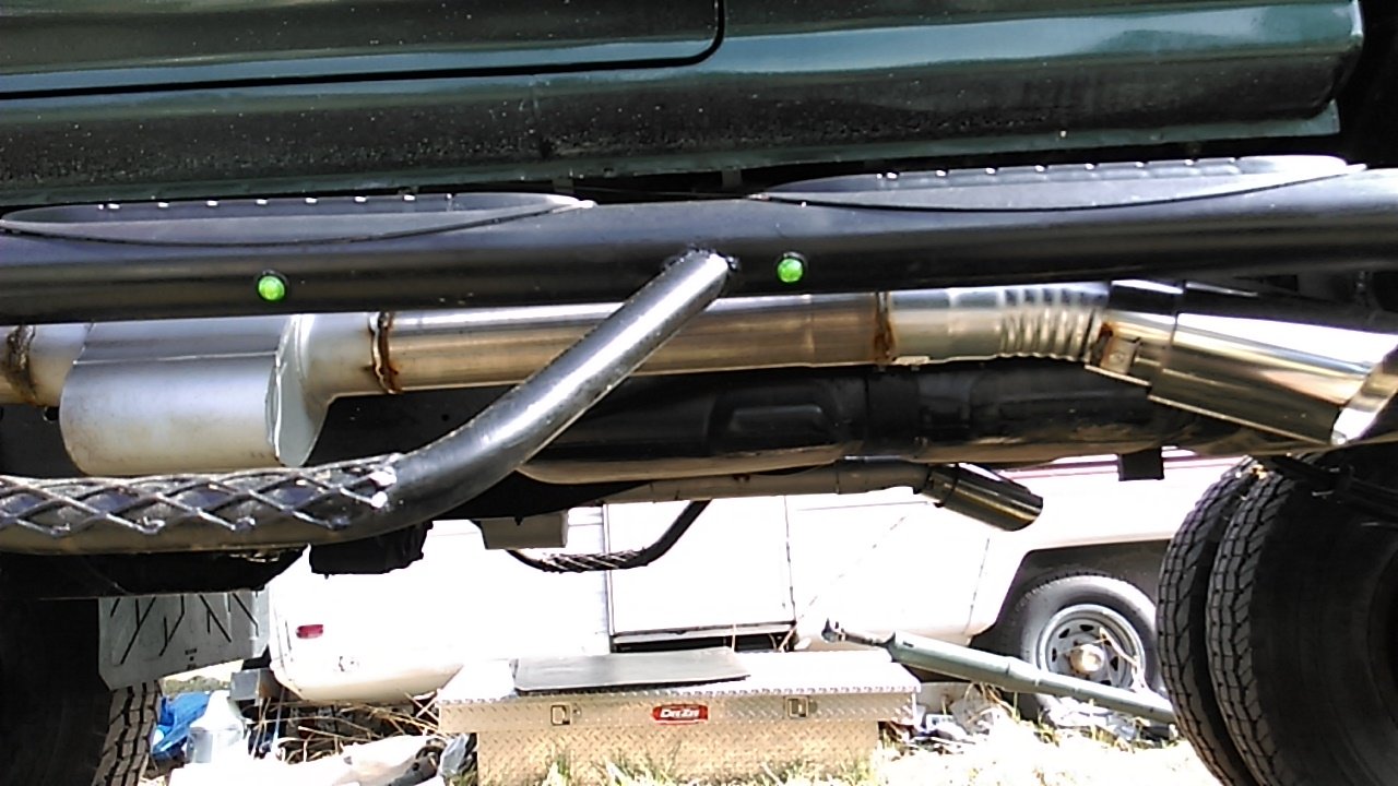

    IMAG0080.jpg IMAG0079.jpg my tow mirrors and about the best pic I can get of the duel exhaust

    318 SMALL block with forged eagle crank and rods kieth black pistons 10.1 mother thumper cam Torquer intake and a 750cfm demon carb hei ignition and a 4 core aluminum radiator for a big block the transmission is a torqflight 727 with a bnm trick shift kit and duel transfer cases a np205 and a np203 tripple stick my axle gear ratios are 6.72

    So you just slapped a tacoma body on another truck?

    a dually taco. shit if it had a cummins this could of been the ultimate redneck mobile.

    Looks Stout, and those axles from a military donor truck, it tucks them driveshafts.
    Whats the GVW?
    Change up the headache rack, I think it would look more suave.
    I like the look without the dual rear tires, paint them black or same as truck.
