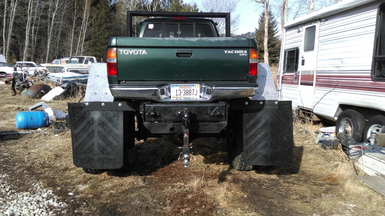

    2.5 ton Rockwell axles out of an m35a2 frame is a 1 1/4 Ton M880. Dodge 318 ci V8 torqflight 727 with a 2000 Tacoma with 390,000 miles on it that my wife bought brand new in 2001.
    The truck has a 10 in soft ride Chevy leaf spring lift kit 14 in travel shocks and 8 in perches NOT blocks there fully welded to the axle the driveline sits 9 1/2 inches above the center of the axle and3/4 in u bolts I'm in the process of molding the rear fiberglass fenders I'll do the front next week it's only about 65% complete I have a lot to go!!!
    It weighs 7,500lbs and will pull a freight train these are my old fenders I didn't like themIMAG0028.jpg
    318 la with a few mods I posted earlier
    It runs the drum Rockwell breaks I'm running the stock break booster with an adapter to a Chevy 1ton dually hi flo master cylinder to feed the massive wheel cylinders if I stomp the breaks it will lock all 6 tires no abs stops on a dime
