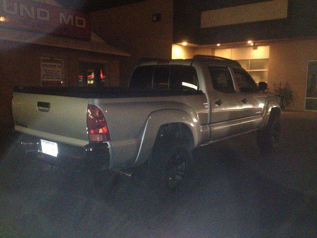

    After running from place to place to get tools to deal with sticky bolts and the various breaks to eat. I now have the lift put on my truck as of late last night! Lets just hope all is correct and sound... I plan on getting an alignment later today.
