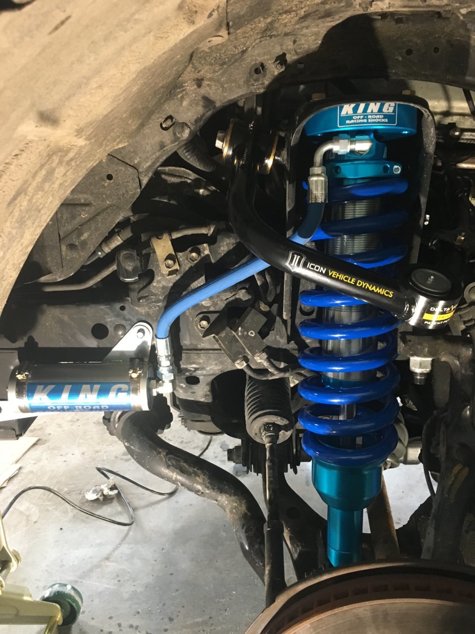

    Just installed some kings on my GX470 last weekend. Wasn’t terrible with only myself installing them. Definitely helps with another person.

    I miss my kings looking that shiny and new

    You mean they don’t stay this way!? I thought that’s why they cost so freaking much:rofl:

    Make sure and keep them UCAs greased up. One of mine failed after 2 yrs of abuse. luckily you can replace the bushings and delta joint for much less than the initial cost of the UCA.

    Order a can of Fluid Film and keep them sprayed down throughout the winter season. You might also consider upgraded rack bushings, cam tab gussets, spindle gussets, and maybe UCA gussets if you plan to smash around. You can find them all through Total Chaos

    Cam tab gussets are on my list. Spindle gussets I have heard mixed reviews. Don’t think I am going to beat on it enough to have UCA gussets.

    If they'll fit your wheel backspacing, I don't see any reason not to, unless there's something I'm missing. I've seen stock spindles fold with moderate abuse, and cracked the top cup clean off my own even with the gussets. I've had good luck with TC gussets coupled with a 1/8" wrap around the outside of the upper uniball cup to prevent separatino on longravel and midtravel applications in the past.
