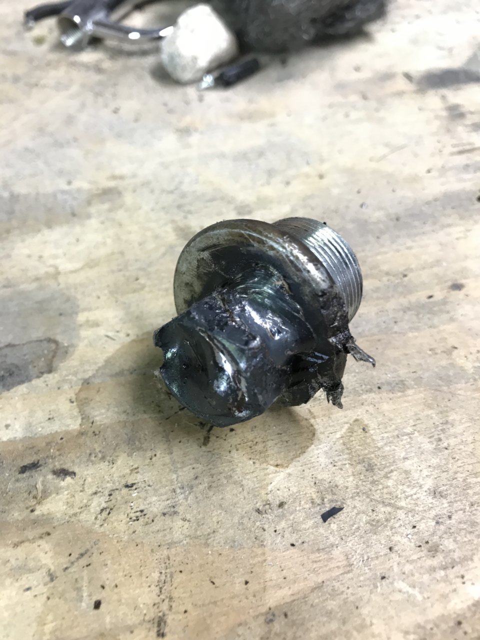

    I’m at my wits end with the stupid front differential drain plug on my truck. Damn thing will not come off. Initially stripped out the hex fitting, and have been wailing on it all morning with a hammer and chisel after soaking it in penetrating oil. At this point I feel my only option is either drilling it out (which I’m still scared of not getting it out after doing so) or welding a nut on there and using a breaker bar.
    Anyone in the Billings area willing to do a little welding for me? I’ll bring the beer.

    I had to weld a nut on one of mine.
    [​IMG]Front diff assembly-2.jpg by Monte Nickles Photos, on Flickr
    [​IMG]Front diff assembly-3.jpg by Monte Nickles Photos, on Flickr
    basically means you should pull it to get to it. You have to fill the plug then weld the nut on.

    After lots of heat, more banging and more chiseling into the night yesterday with no success I gave in. Called up silent knight exhaust here in Billings this morning to weld a nut on. $10 and 5 minutes later the thing came off with ease. Frickin A shoulda just done it in the first place.
