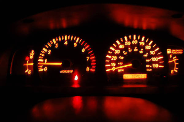

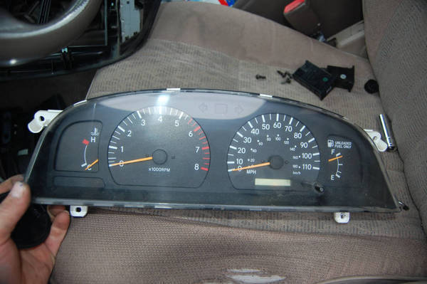

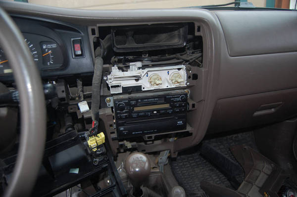

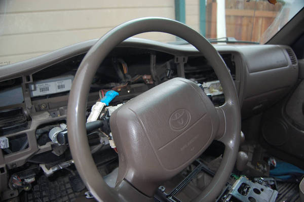

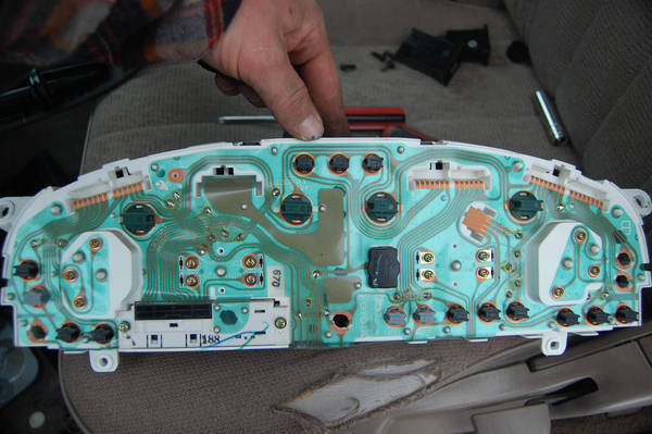

    I've never really liked the color of the dash lights on my truck....kinda outdated looking. Since one was burned out behind the gauges and another behind the HVAC controls I changed them to orange.
    Took me 5 min to get to this point to replace the bulbs behind the HVAC controls. Stealership wanted $60 to replace that one bulb!!
    The four big green twist tabs (or whatever they are) are where the lights are.
    A little blurry! Looks like the dash lights on the 01-04 tacos and I like that color a lot better. Seems to be easier on the eyes than the green when driving at night.
    For anyone interested in doing the same I found the project really easy, just a little time consuming to get to the gauge pod. The # for the lights for the HVAC are a 74 (2 bulbs) and the ones behind the gauges are a 194 (4 bulbs). I bought the bulbs at O'Reilly's and was told that those numbers are the same for all bulbs of those sizes no matter where you buy them. Just not sure if all 1st gens use the same bulbs though.
