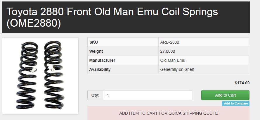

    Well, I may fast foward and order the OME 2880 Coils to pair with my 5100s (lowest setting).
    I'm at Low Range hovering over the trigger!!

    Lol... that may save you money in the long run brotha. OME are less likely to sag (although I haven't personally seen Moogs sag) and they will probably ride nicer.

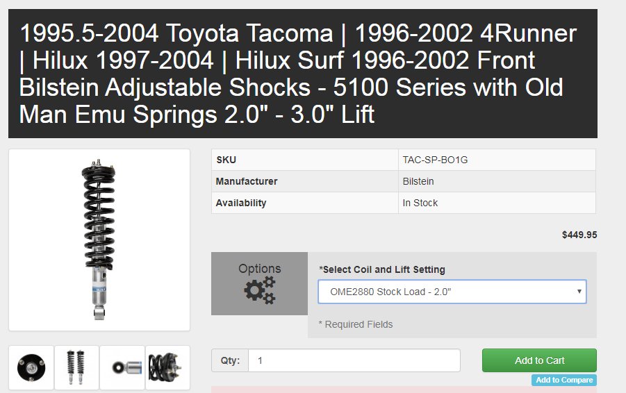

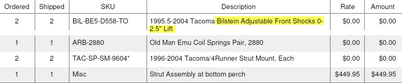

    Sent the Moog 81104's back, and I'm currently waiting on LowRange to email me with a quote for the Toyota 2880 Front Old Man EMU Coil Springs / Bilstein 5100 combination.
    I already have a set of Bilstein 5100s on the front, but they are right at 4 years old and are the older style (3 settings). I think the new ones have 4??? I may be wrong on this.
    I contacted LowRange about the setup below, and asked if I could get the 5100s set at "0" or the lowest setting. So as of today, I'm waiting on the quote.

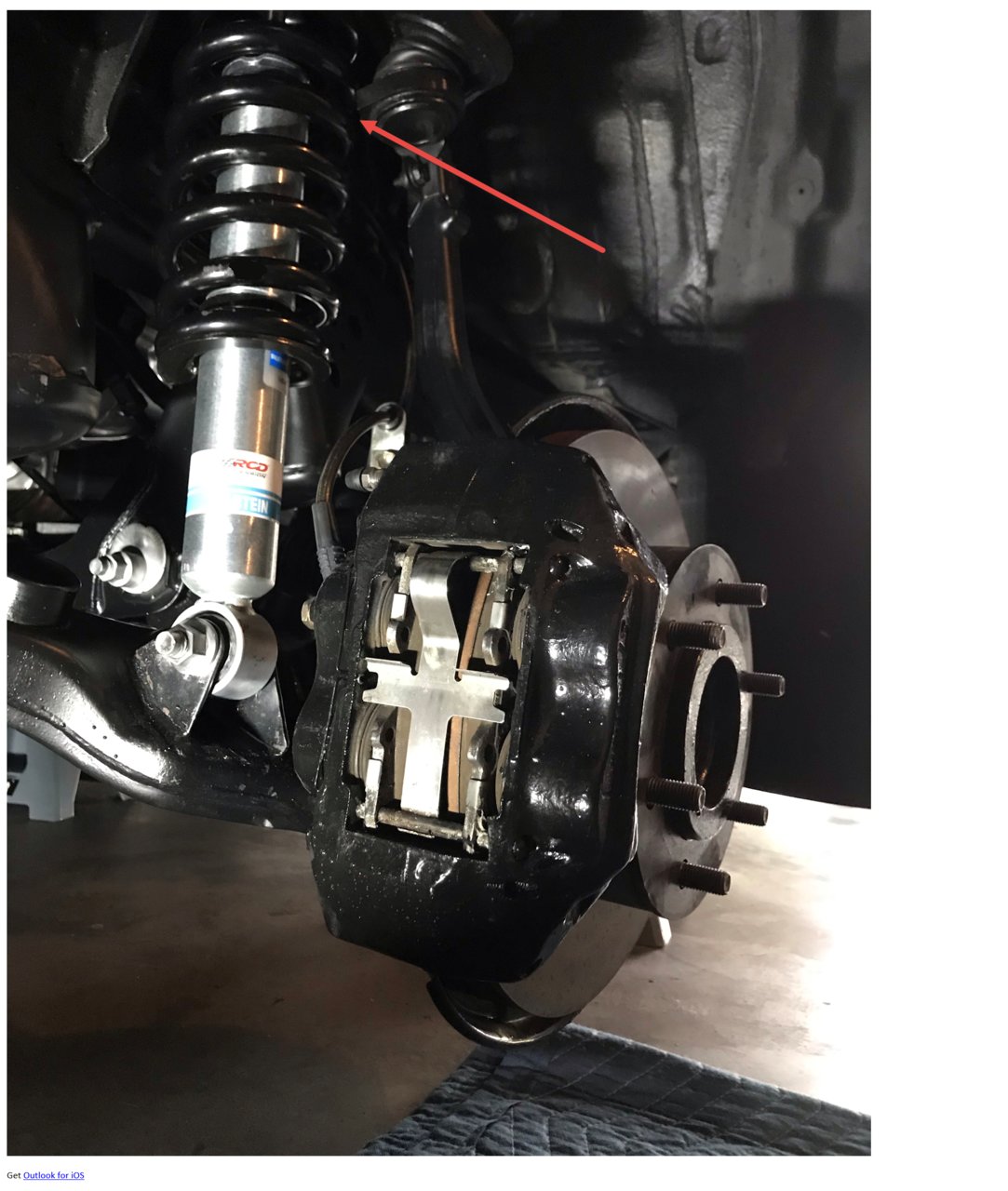

    Got a question for you guys that have way more experience with suspension setups than I do. Finally installed the OME / Bilstein 5100's (0" setting) from Low Range. Talk about a live and learn experience. Since I replaced the lower ball joints, I already had the outer tie rod disconnected. I also disconnected the sway bar link which helped in getting the lower control arm down further.
    I asked a friend of mine to come by for some back up. Even with me standing on the brake caliper, we couldn't get the lower mount to line up enough to insert the bolt.
    Finally used the upside down bottle jack method which worked like a champ!! To help distribute the force being put on the top fender well, I placed a piece of scrap 4"x2" up top.
    My concern is that the upper knuckle is extremely close to the coil, and even hits when you turn the hub left/right. I'm hoping this is because the outer tie rod isn't connected yet (waiting on new ones to arrive), and the truck hasn't been lowered off the jack stands.
    Is this the case???
    Answer: TW Member Uphillshunter informed me this was caused by the suspension being at full droop. He was correct. Once the truck was lowered, it was corrected.

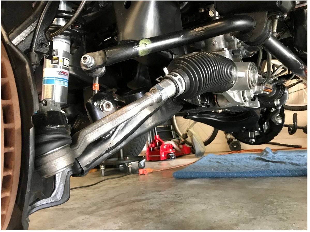

    Finally got the below task completed Friday, and the front end is now tight!!
    • New OME 2880 Coils with new Bilstein 5100s (set to 0).
    • New Inner Tie Rods (555 from Low Range)
    • New Outer Tie Rods (555 from Low Range)
    • New Rack Bellows (from Low Range)

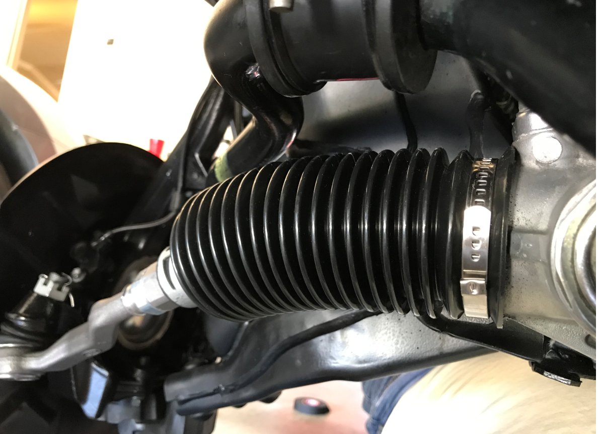

    • New metal CV style boot clamps from Amazon. Could not locate the original style clamps that secured the bellows to the rack. I usually find everything at ToyotaPartsdeal.com, but they showed it as discontinued. Local Toyota Dealer said they were not able to get them.
    • New OEM Lower Ball Joints from Camelback (included bolts)
    • New sway bar links (555 from Low Range)
    • Went Saturday and got a front end alignment.
    There was a LOT of frustration in doing the above but it was a valuable learning lesson, and I'm loving the ride!! One reason I was wanting to get new coil springs was due to the body roll when going around corners. That is no longer the case. I was afraid the ride may be harsh, but it's not much different than before.
    I had a little play in the steering, and now that's gone. It's like a brand new ride again.
    Appreciate all the suggestions and Tim the Toyota Man for his videos.

    New bellows from Low Range with metal bands installed

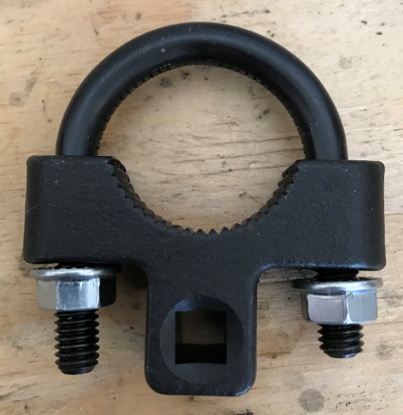

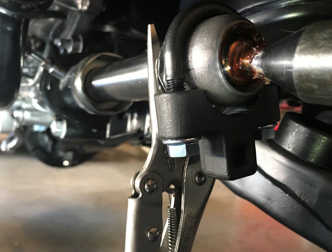

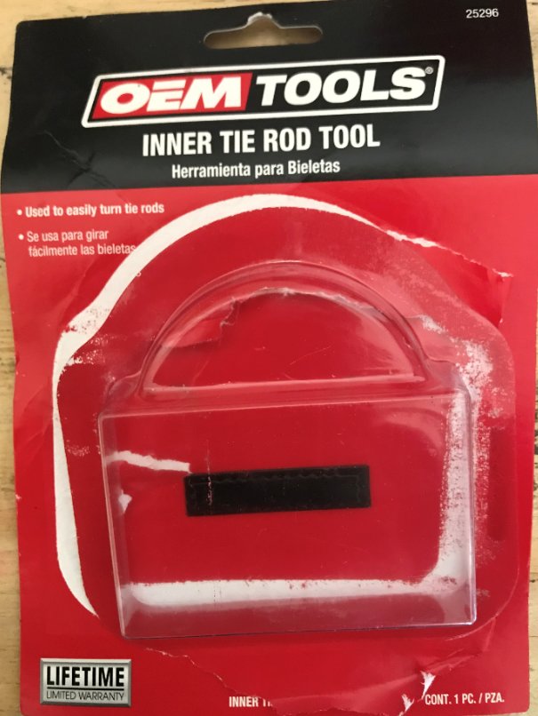

    If you do the inner tie rods yourself, I highly recommend this tool. I got it from AutoZone. Best $20 I spent!!
