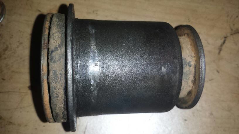

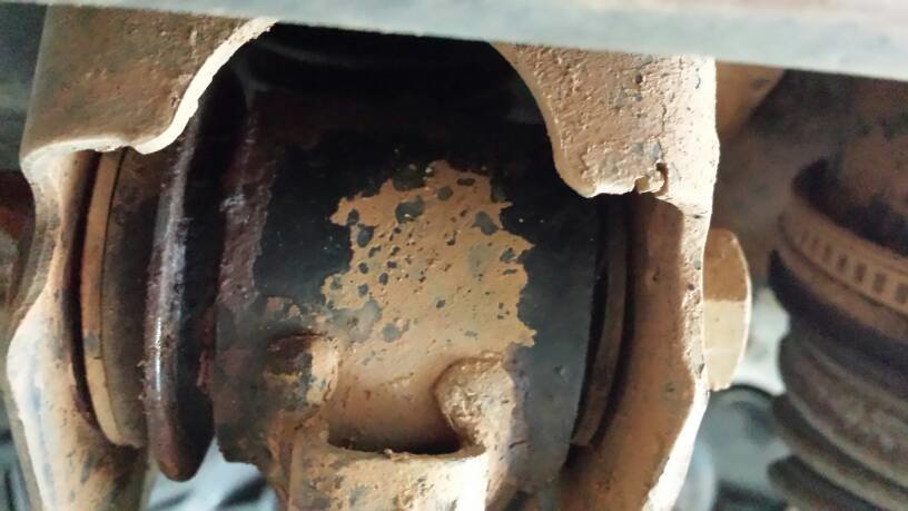

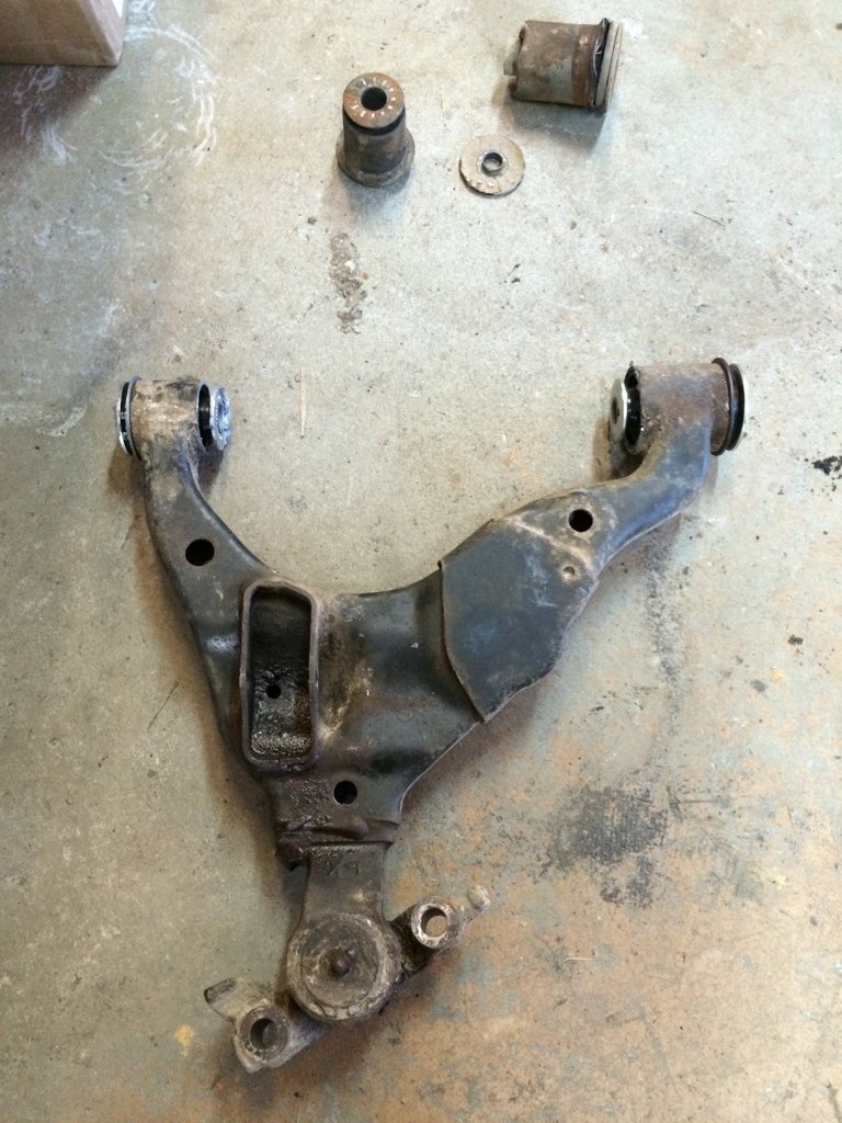

    The moog front (smaller) lca bushings are not working out for me..
    I finally figured out my Pop,Clunk,Bang,Knock in the front end. The diameter of the Moog bushing sleeve is too small and is "breaking loose" from the LCA..
    https://www.youtube.com/watch?v=s-Ub2rUdqEI
    Front bushing
    Rear bushing

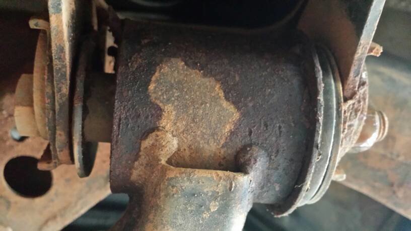

    What really sucks is, although moog dropped the ball on this, it's really Toyotas' fault. I'm guessing most of you are in the same predicament I was - needed an alignment but couldn't get one because Toyota doesn't lube the bushings and alignment hardware from the factory, it rusts solid, and we're stuck cutting it all out and replacing it:mad:. My bushings weren't bad themselves. There should be a sticky warning new owners to disassemble and lubricate as soon as possible. Much like the hub assemblies NJ636 gets to make us thanks to Toyota, the threads I've read by people replacing are finding the originals to have had very little lube in them. Talk about being f'ed with no lube.

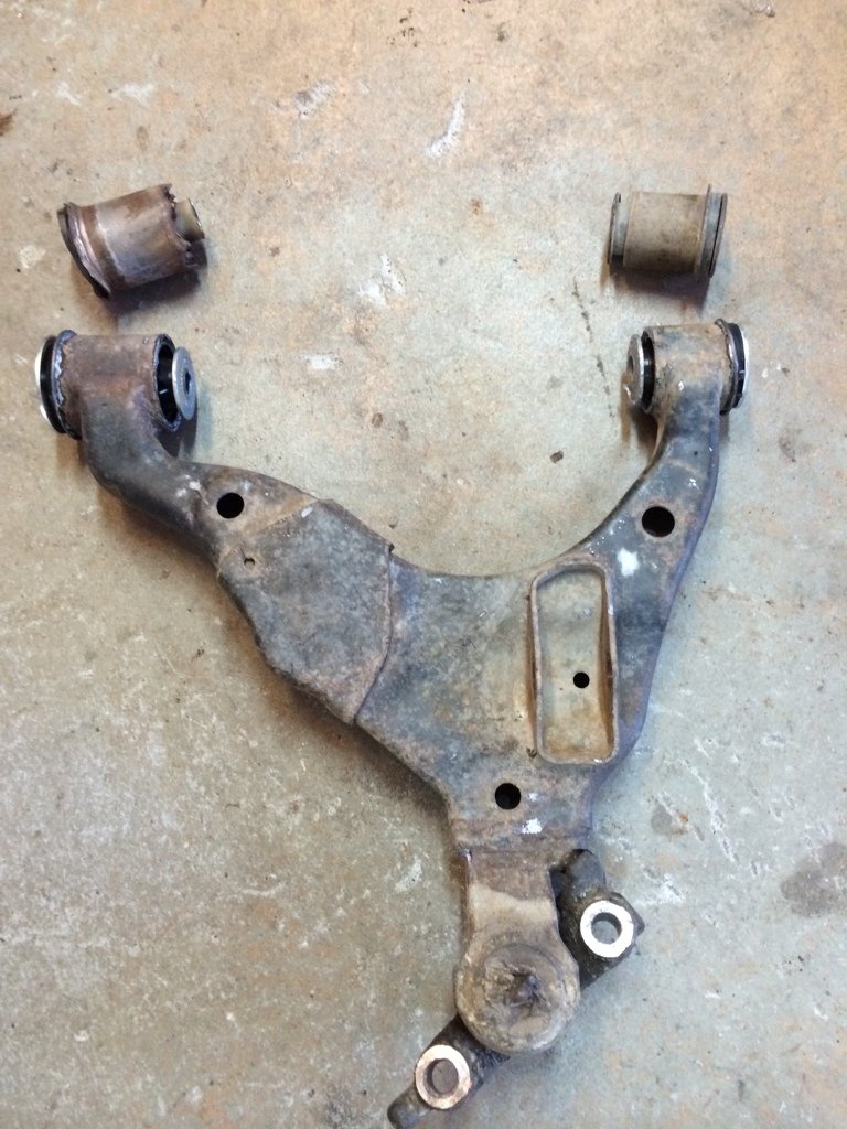

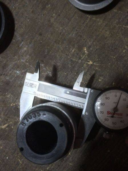

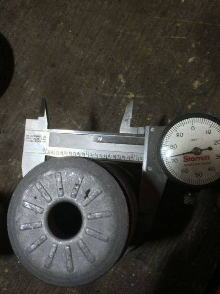

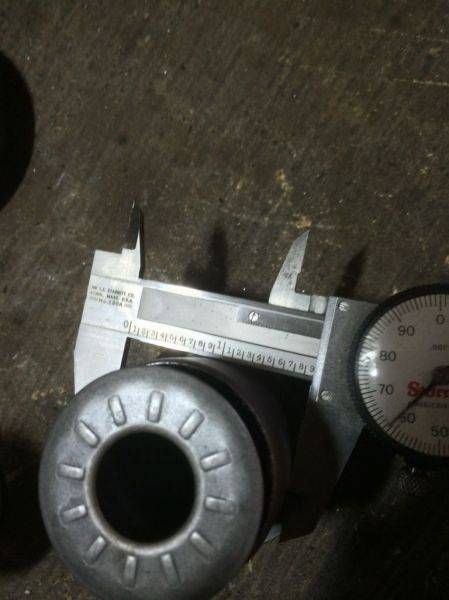

    new poly bushings arrived -- measurements:
    1.873
    1.897
    I will install & report back

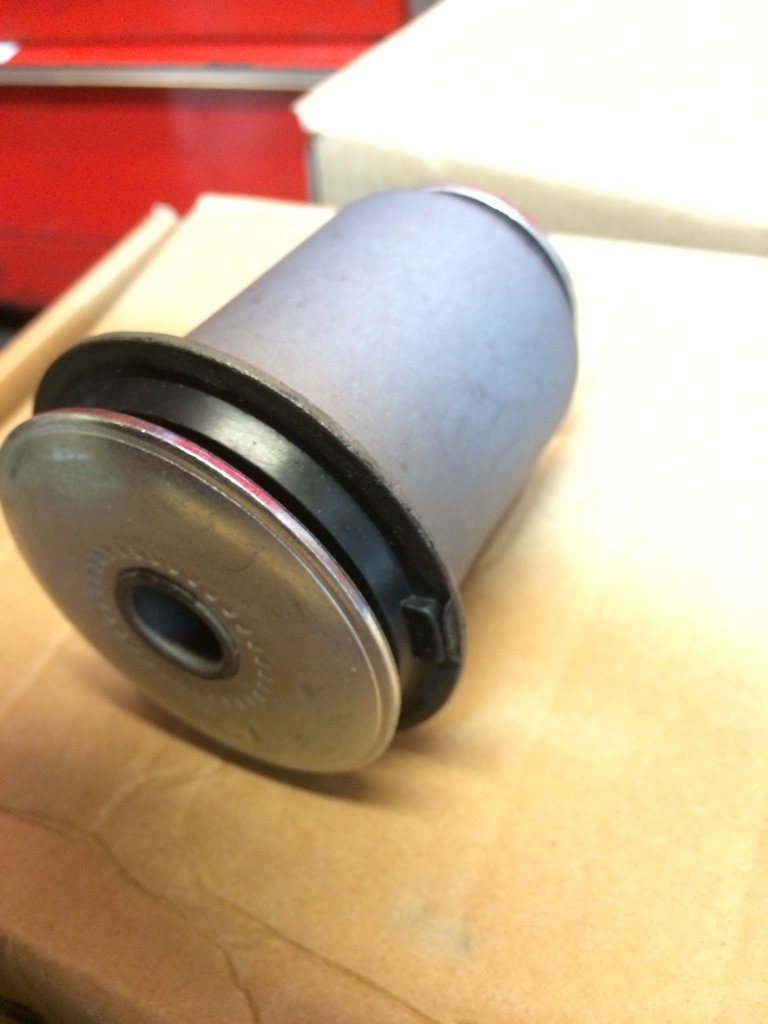

  15. Jun 29, 2015 at 7:47 PM
    nj636
    nj636 Hub Master General
    Feb 14, 2012
    #72804
    5,389
    Kev
    Jersey
    OME lift 4x sliders 4x skids
    sneak peek :spy:

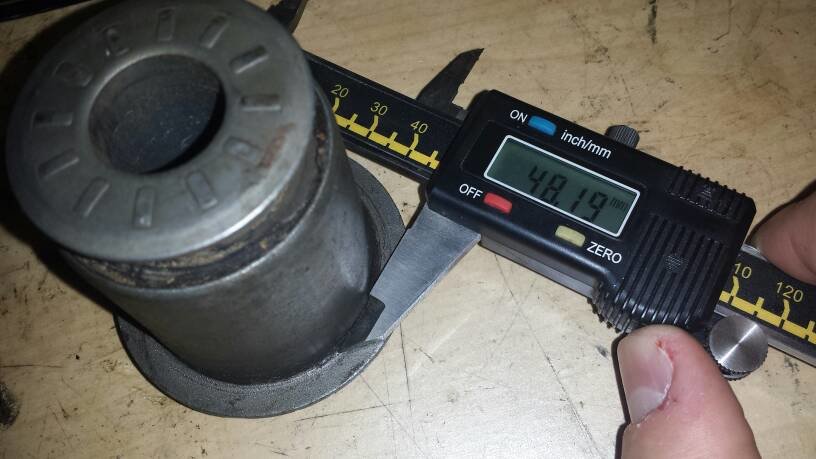

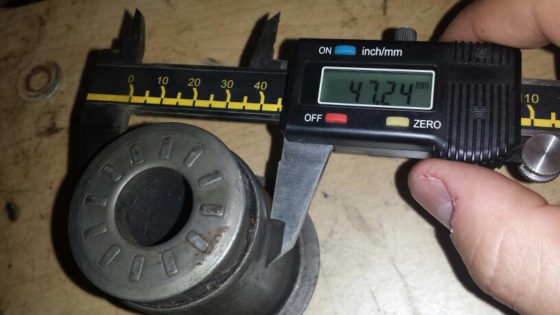

    I would like to invite everyone that has had this issue to take measurements of your K200773 Front Lower Forward Control arm bushings. Post them here and make RockAuto aware of this safety issue. They have so far unsatisfactorily addressed this issue and are claiming that this is not a wide spread issue. I will re-post my measurements for science.

    swapped out the Moog LCA bushings this past weekend. I installed Mevotech MS86410 ($31.79 ea) & MS86409 ($30.79 ea) poly bushings. Only have about 20 miles on them so far but no clunk. I will get the go pro back under there if I hear anything.
