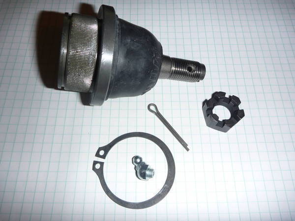

    I haven't seen any condensed info on any of the sites and since these are typical wear items on a 4x4 05+ Tacoma I figured I would throw out some part numbers and pictures for all to see/use when they have the same issues.
    I have never used Moog before, so I contacted some guys I know before investing in their parts. No one had anything bad to say so I choose Moog for all of my parts. I purchased everything from Rock Auto Sunday night and it was all delivered today (Tuesday).
    Moog's designs seem solid and they have serviceable tie rods and ball joints that should last much longer then OE as long as they are taken care of.
    Please note there are 1,000 ways to skin a cat and many other parts from different manufacturers that can be used. This thread is just a summary of what I used.
    Tie rod
    Part #: ES80895
    $24.79
    LCA ball joint
    Part #: K80827
    $36.79
    [​IMG][​IMG]

    Time will tell ultimately, but I'm impressed by their design and overall quality right out of the box.
    No missing parts...check
    No rust...check
    No defective/ripped/weathered/dry rotted boots...check
    No forging or mold issues...check
