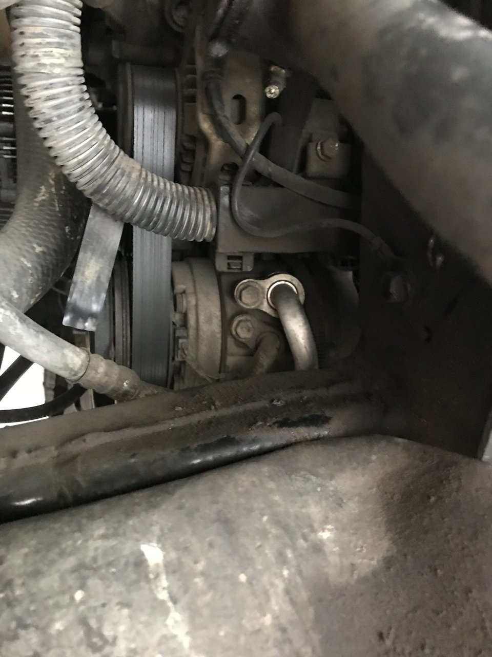

    I think I’ve found the source of my noise..... ac hardline mount. Tightened it up and haven’t heard the noise when I bounce the truck up and down..

    Very good. One loose bolt huh? Is that looking down at it or from underneath? All that hardware you replaced. Anyway glad you found it. On mine I doubled checked the LCA cam bolts and one was a bit loose. Probably took a half a turn to get to 100ft/lb. Its better now but still if I hit the dip hard I still hear a slight click. I'm sure my LCA bushings are pretty shot by now? 6 years and 75k mi. Maybe I'l just slow down over the infamous dip that always shows it? LOL
