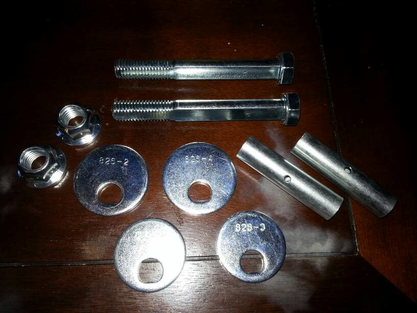

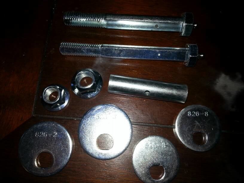

    Just noticed one of the bolts in the open kit is a smaller bolt than the other three....... Ugh!!

    So Rockauto is sending me 2 new sets, and have asked me to return these sets. The guy on the phone told me that these will not be restocked, and also confirmed that they have had multiple issues with this part #.
    Just to be perfectly clear, the bolts should be 2 different sizes. The larger bolt uses washers 826-4, and 826-2. The smaller bolt uses bother 826-8 washers.

    Well that's really making me second guess these.
    Are both your front and rear bolts the same size? Do both bolts have sleeves?
    Here's a pic of what came with the first kit. 74ab5cd969f9cacfd4d64e350bce36c2_78f5f1929f17bfc13f019ff8011912019ef73022.jpg
    Here's a pic of what I got with the other. 37b2ab6cfccf1c590c305479cfdf344f_4b6f0523d7d2284a6b6b32399dc1d0239c36135f.jpg
    ***just an FYI cause it was mentioned I the first thread, the 826-8 and 826-3 are the same outside diameter. The difference is that the -8 fits the smaller bolt, and the -3 fits the bigger bolt. ***

    What was the # of the one that stripped out on you? Did it fit the bt tight? Just wondering if it could have been a -3 washer on the smaller bolt meant for a -8.
    Edit: nevermind, I just checked and the -3 just spins on the smaller bolt.
