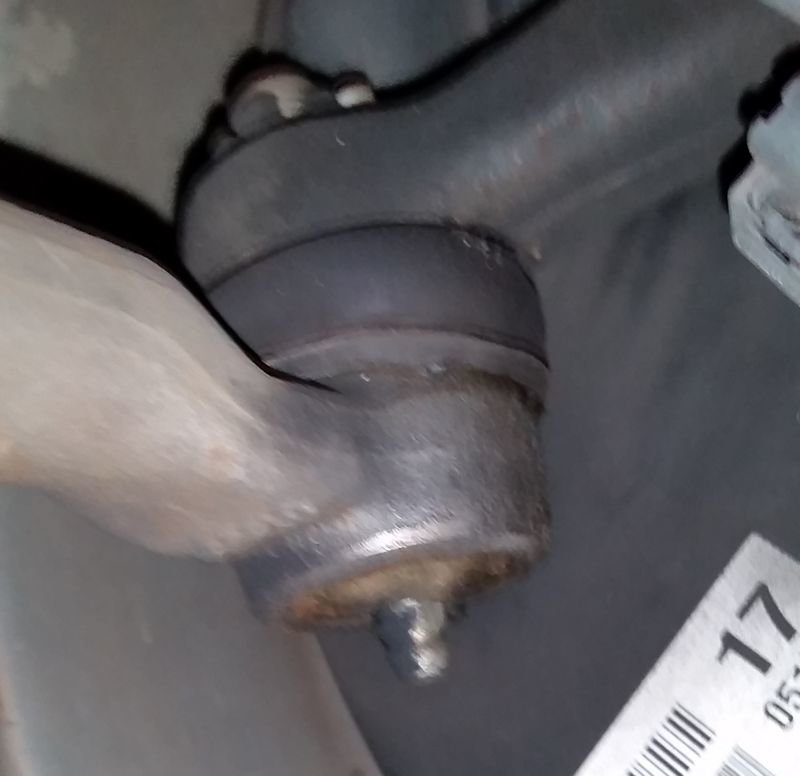

    2 years and so far all looks good. FWIW I greased them after installing.

    This makes sense, so does that mean the grease seals on the u-joints work under a different principle? The method for greasing the u-joints is "pump until grease oozes out".
    I installed mine yesterday and just greased them until they ballooned up (but no grease oozed out yet). At first, when installed, they boots will be collapsed/folded on themselves, but once you pump enough grease in there it pushes the boot outward and looks like post #49. That's how I left mine.

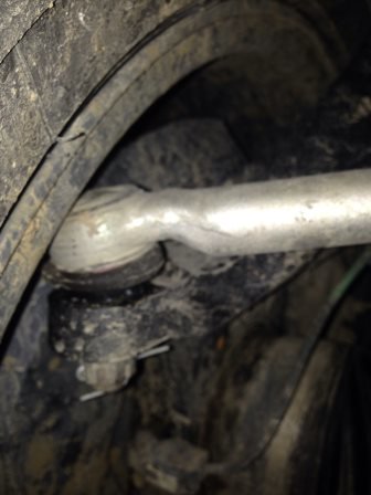

    this is a tad bit off subject but i can anyone explain to me why my tie rod ends are "upside down"? every tacoma i see besides mine seem to be 180º from how mine are. does it matter if they go this way or not?

    if you notice, my tie rod ends are so dam close to the rim that i was barely able to fit a credit card between the tie rod end and the rim. so i ground it down some to get it away from the rim. (after i put the lift kit on with the new knuckle)
    do yall think its possible that the shop installed my tie rod end upside down?

    Yes
    That is a truck with a drop bracket kit, if you look close you can see that it is not an OE spindle. DB kits flip the TRE over like that to maintain proper steering geometry with a 6" lift. It is to prevent bump steer. That is also why you hear that drop brack kits require an 18" rim with 4.5 backspacing. That guy clearly has 17" rims and his TRE probably hits the rim at droop.
