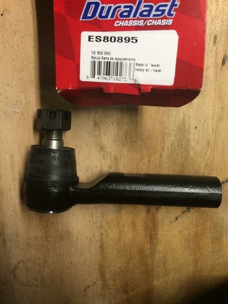

    As it turns out,
    The Duralast tie rod ends are different from the Moog, despite the same part numbers.
    The boot design is good on the Duralast. I bought their inner and TRE's installed last week and so far they're working great.

    Duralast are made by federal mogul but are equivalent to quick steer, not moog. They only use moog when there is no quick steer available.

    Dustin boot looks nice but the casting looks kind of sketchy.
    Time will tell how they hold up so maybe a long term review could be in the works. :D

    Well, it looks like the Duralast ES80895 is now different.
    I got lazy and ordered them online thru Autozone due to a time crunch. The boot design is different that what @Crom has pictured, also...NO GREASE ZERK! Which is a major disappointment.
    The boot design seems good though.

    Damn. What a drag! I posted the product link above, here it is again, picture on their website shows grease zerk fitting, and it's even listed in the description! Grease Zerks Included: Yes
    I would return to store, and check local store stocked items. I wouldn't be surprised if Autozone had the part supplied from multiple manufactures, hence the variation in the product.

    Just to follow up on this... I went back to my local Autozone, the stock they had on hand were the same as the ones I received. The new design has NO zerk apparently.

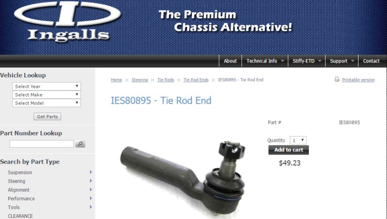

    Has anyone looked into or tried this brand of outer tie rod end? Looking at doing this soon and with the amount of problems MOOG seems to be having I'm looking into other serviceable options.
    Ingalls -
    IES80895 - Tie Rod End
    http://www.ingallseng.com/ies80895-tie-rod-end.html

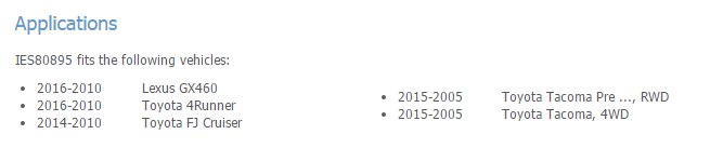

    Wow. I see a pattern, you guys see it too?
    Looks at tha part numbers:
    How much you wanna bet, it all comes from the same factory?
    :D
    If the Ingalls has that boot with the bellows, I bet it's fine. Similar to my Duralast boot.

    Yeah I saw that too with the part #'s but looks like the boot design is better than what else is out there. Was attempting to get the same tie rod ends that @Crom has but unfortunately Duralast had to go cheap and change their design. I just ordered these through Amazon so will report back on how they are built and hold up after install.
