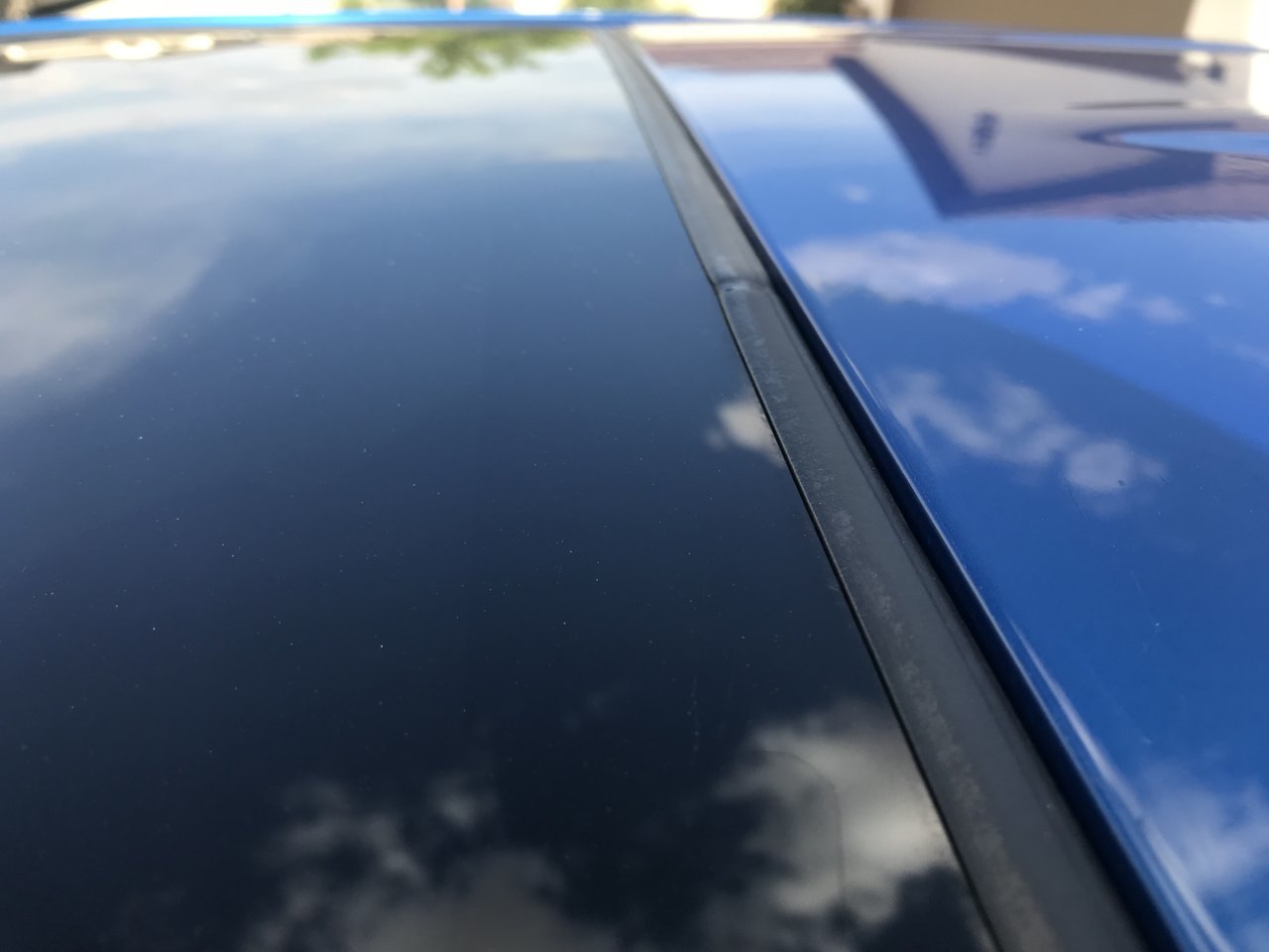

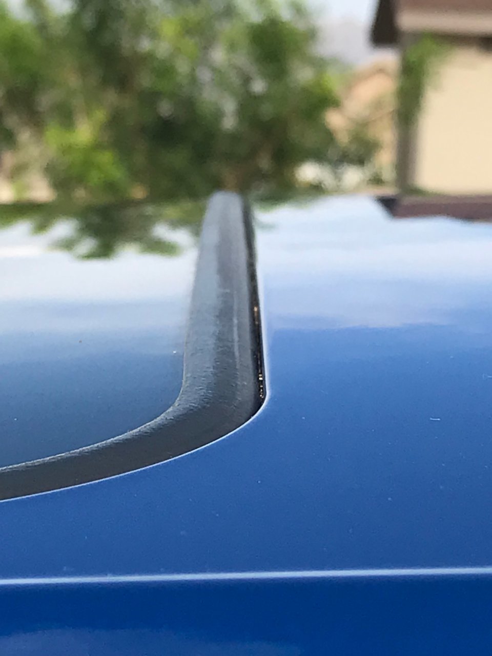

    After having to leave my truck at the dealership overnight I picked it up today, and the roof seems to be working to keep out water poured from a pitcher, but still leaks when taken through a car wash. I have caved to the understanding that a car wash will make the seal leak, but I am having a hard time trusting the seal against rain. Toyota is claiming that the moonroof is allowed to leak a little and that it's nothing to be worried about. I really don't know, after hearing from everyone I really don't trust Toyota.
    I've attached images of the seal in the closed position. To me it looks like there is still a small gap, from what I've seen of these seals they are typically pressed tight up against the metal of the roof.
