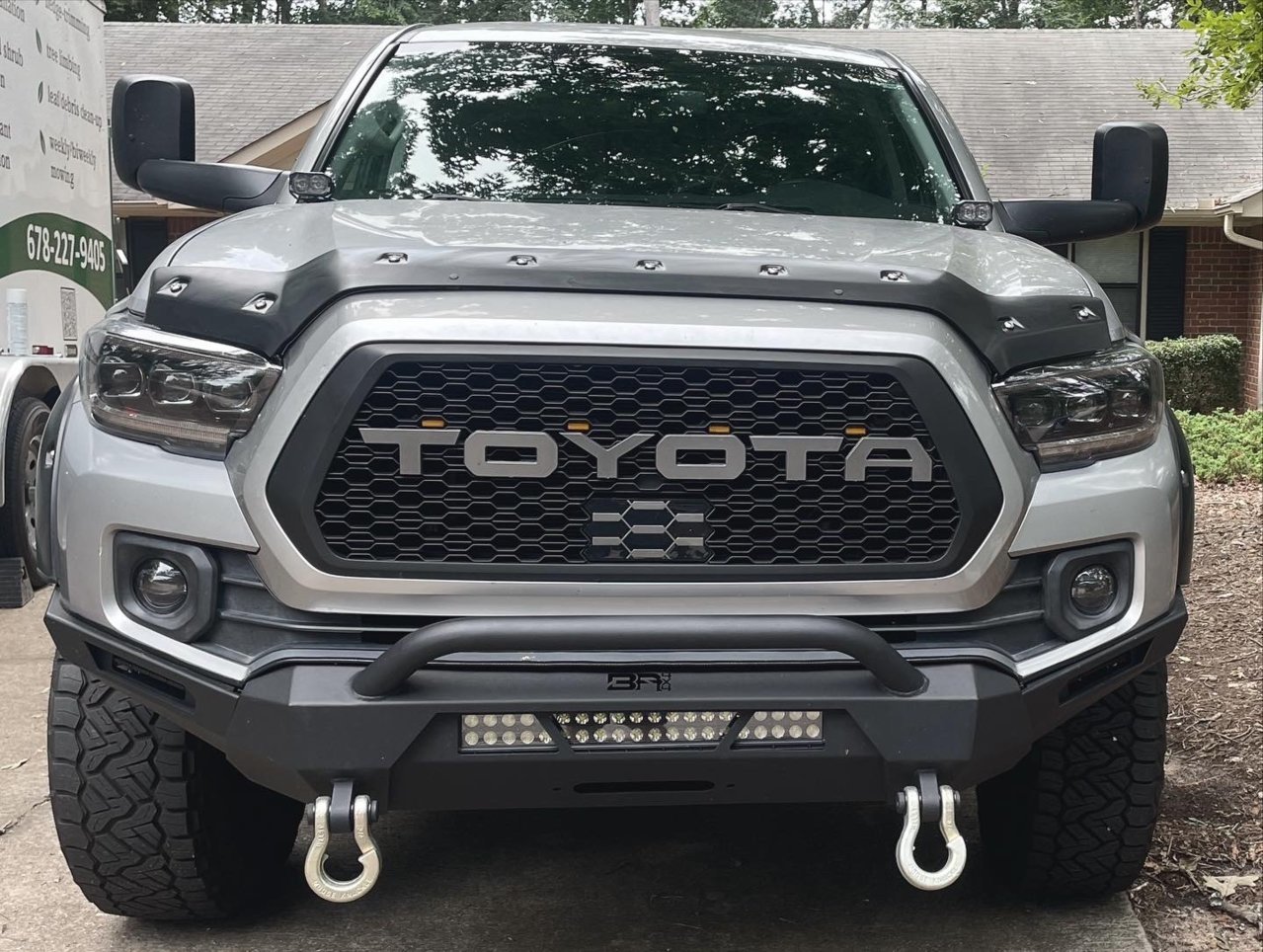

    Also they’re made in America and they don’t clunk around even after being worn in for years lol I have 3 pairs and a couple of my friends have some as well. None of us had ever had an issue with them except over a long period of time the color will fade. 57AEAD62-0A60-4454-B571-BFF8320EFEC2.jpg
