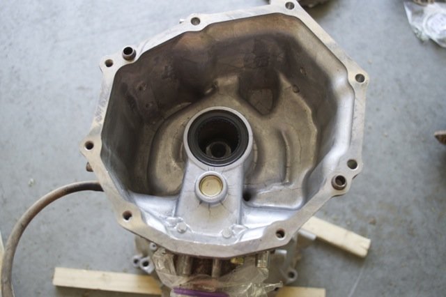

    the output shaft seal on the MT has a tendency of going out as well. I read about it in several places and ordered one just in case as I had a slight gear oil leak that seemed to be at the t-case/adapter joint. When I did the clutch I pulled the transfer case off the MT and found the adapter body was full of gear oil.
    http://www.tacomaworld.com/forum/1st-gen-builds/259729-tomtoms-03-trd-xtra-cab-36.html#post8681777
    I wish I had known that it was common to do the engine rear main seal but hopefully it'll hold until next clutch job. vroom, vroom.
