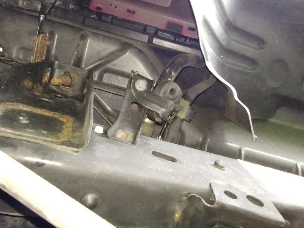

    I had the frame on my '06 Access Cab replaced under warranty about five years ago. After getting the truck back I found a number of areas where the work was either shoddy or worse than shoddy. Most of it had to do with missing clips, foreign (non-Toyota) clips, dangling wire support brackets, etc.
    It seems that almost every time I start working in a different area, I find another instance of what, in this case can only be described as butchery.

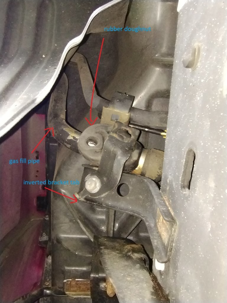

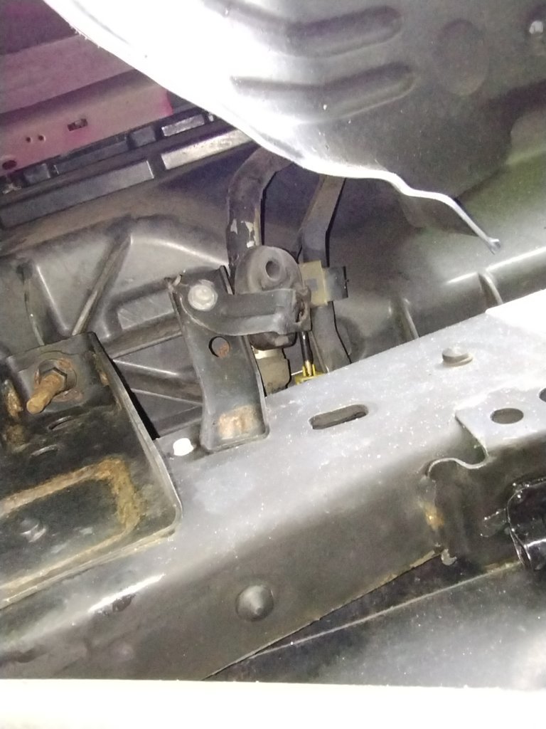

    Here is a photo what this particular dealer did in the area of the gas tank fill pipe. It looks like they stuck a muffler hanger doughnut in there and maybe turned the metal bracket inside out, judging from the little position tab on the end of the bracket!
    It's particularly galling because the dealer had the truck for about 10 days and either has the parts or can readily order the parts to do the job correctly.

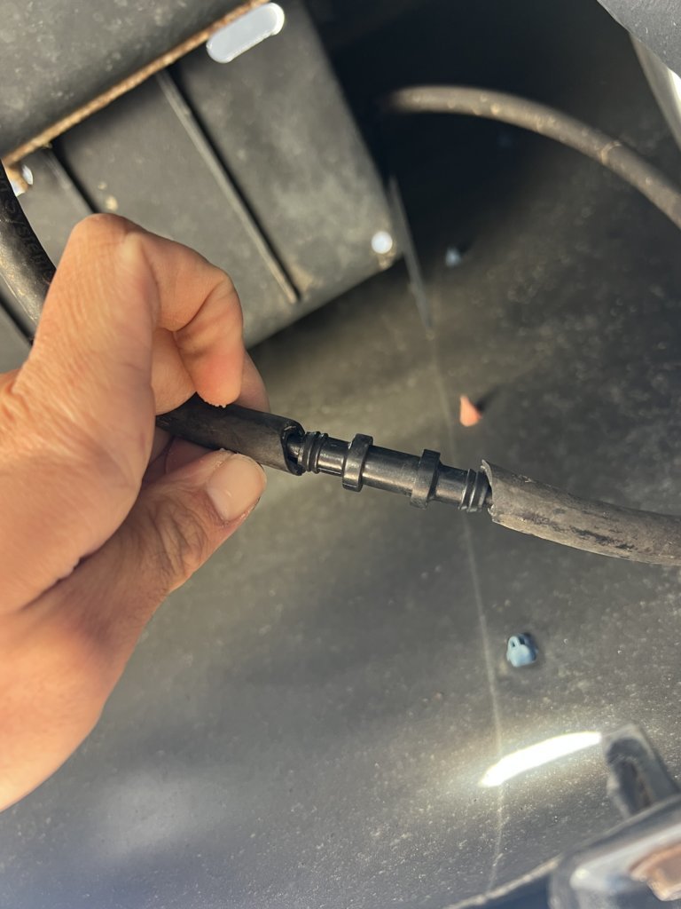

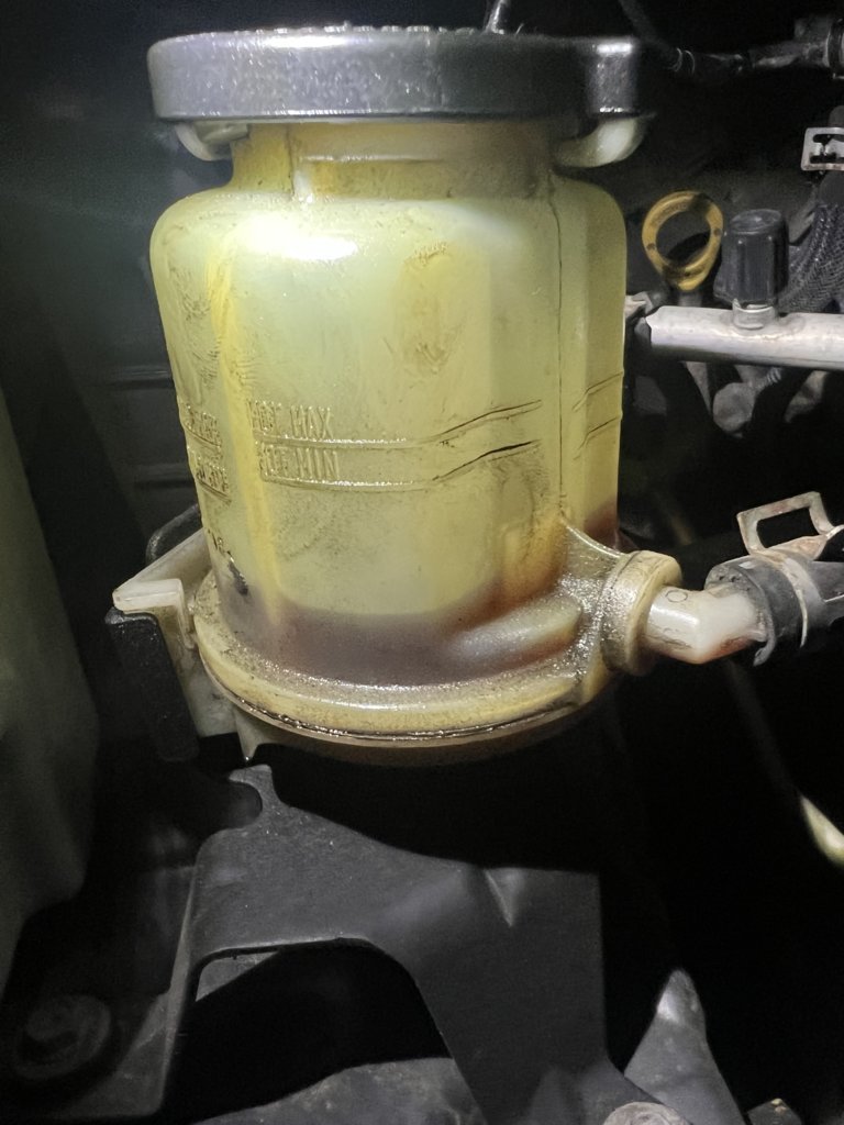

    Yea I dealt with the same thing on my frame replacement last year. Pretty much all the clips that hold the wiring loom to the frame back to the rear of the truck were broken and the loom was left hanging. The bolt that attaches the ABS wire to the UCA was sheared off and the wire left hanging. IMG_7951.jpg They replaced the power steering rack while they were there (which I paid for the part of course) and forgot to refill the fluid reservoir. IMG_7953.jpg The dealer tried to make me pay for a lot of the covered ancillary parts to the tune of about $600 plus labor until I argued it. I also paid for a new AC condenser? They said they snapped a piece off the old one upon removal and there was no way they could cover that part after dealing with Toyota corporate, I call BS. At that point I was so done with dealing with the dealership that I fixed all of the issues I could see on my own. They also didn’t realize that I had extended the rear differential breather and snapped the hose in half and pieced it together when they were separating the frame from the cab, I can’t blame them for this one though. IMG_8736.jpg Makes me wonder if I can trust all the other work they put in being that they took the entire truck apart and put it back together. Oh well, I got rid of the rotted out frame.

    My sentiments exactly. I was grateful that Toyota replaced my entire frame and did inspect the truck on a lift at my client's body shop immediately after picking up the truck. A number of the things that I found were pure sloppiness and/or evidence that the mechanic (and maybe the dealer too) couldn't care less about replacing everything correctly. For example, numerous clips and brackets left out or incorrectly installed, etc...
    There was one glaring thing that I found when the truck was up on the lift. They had sliced (about 5 inches) into the transmission tunnel with a Sawzall or some similar tool. I called the dealer to let them know what had been done and they asked me to bring the truck back and "they would see what they could do". I declined the dealer's offer because I did not trust that they would would anything correctly. Since that time, I've been repairing or replacing each of those little parts, one by one, as I discover them. This rubber doughnut was only discovered last week when I was under the truck removing brackets to sandblast them and treat them with POR-15, a few at a time. I still have to figure out what part was originally there to hold the fuel filler pipe in place so that I can replace it.
