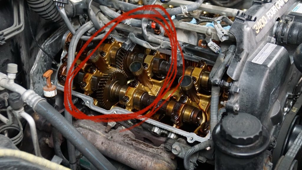

    Alright, it’s been a while, but I found the source of the noise.
    It wasn’t a vacuum leak or a belt. It’s coming from the passenger side camshafts- the gears that connect the two camshafts together. Those gears are what’s whining.
    They look to be in perfect shape. I was doing the VC gaskets yesterday. They don’t look starved of oil, or significantly worn in any way. But I am 100% sure that’s what the sound is. And now, listening there with a stethoscope, it is abundantly clear that is correct.
    Anyone know what might cause these gears to whine? Would some thicker oil or Lucas stabilizer help out?

    Pic for reference. This isn’t my picture, I got it from a DIY on the internet. But the gears circled in red are what I’m referring to.
  17. Dec 6, 2024 at 6:20 PM
    #17
    ControlCar
    ControlCar My Moto: Help & Learn…period.
    Jul 22, 2023
    #429578
    3,603
    Steven
    Sugar Land TX
    1996 Taco 2.4L 2wd Automatic
    Clock Volt meter/LSPV Delete/Hyundai 16’s/FP gauge/after 9months of wrenching ZERO oil leaks
    Hmmmm
    I learned of this recently here
    Typically, if gears are whining……they are binding too much(too tight)
    Look at the(in reference to your pix) the bottom gear
    See the split?
    There are actually 2 gears
    Sorry I forgot what exact name is
    but Smaller gear is spring loaded to guide the larger mated gear
    if entire cam/cam gear removed, there is a specific procedure to reinstall the “guide” gear
    100% another member here has more technical knowledge than me about this
    DoktorSlowburn[OP] likes this.
  18. Dec 6, 2024 at 6:45 PM
    #18
    DoktorSlowburn
    DoktorSlowburn [OP] Well-Known Member
    Aug 28, 2024
    #456061
    206
    Escondido, CA
    1997 White Tacoma SR5
    4runner seats and center console, ARB rear locker, Icon 1.5” AAL, Bilstein 5100 on 4th notch in front (to support future tube bumper & future winch), 4600s in the rear. In-Cab CB radio. Hella 500 Driving lights. All-Pro Baja front bumper.
    That is very interesting.
    I am sure the cams have never been removed from this engine. I guess I can’t be certain, but it’s at about 120k and was swapped in from a scrapped truck by the previous owner. It’s not a 3.4 swap, it was originally a 3.4, just needed a new engine.
    But having serviced the VC gaskets I really don’t think it’s been done before. Meaning that I don’t think anyone would have been messing with the cams. But I think you’re onto something with those dual gear parts there. I unfortunately have no idea how they work aside from keeping the cams in sync.
    Looking forward to seeing if anyone else has input.
    ControlCar[QUOTED] likes this.
  19. Dec 6, 2024 at 6:50 PM
    #19
    ControlCar
    Jul 22, 2023
    #429578
    3,603
    Steven
    Sugar Land TX
    Man
    When I asked a member, they explained everything to me and I was amazed
    I.E. not as simple to take off and bolt on that cam with twin gears
    Lemme search some
    I’m intrigued now
  20. Dec 6, 2024 at 7:01 PM
    #20
    DoktorSlowburn
    Aug 28, 2024
    #456061
    206
    Escondido, CA
    Well, I’m probably not gonna take the cams out myself to be honest. I don’t have the tools or the resources to resurface the head (which I’m pretty sure has to come off with the cams?) And I literally just finished doing the timing job, so I really am not prepared to do that again anytime soon.
    I am definitely curious to see what you come up with but tbh I’ll probably just try using some oil stabilizer and if that doesn’t make it go away I’m gonna just learn to live with it till it blows.
