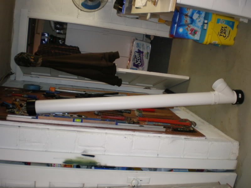

    first, locate the nearest Lowes and buy yourself a section of 4" pipe. The Lowes by me, didnt have anything shorter then a 10' piece, so here it is on the way home 007-11_a9a20c9f430b5d31a26e1d23b9c0975b76483c1e.jpg

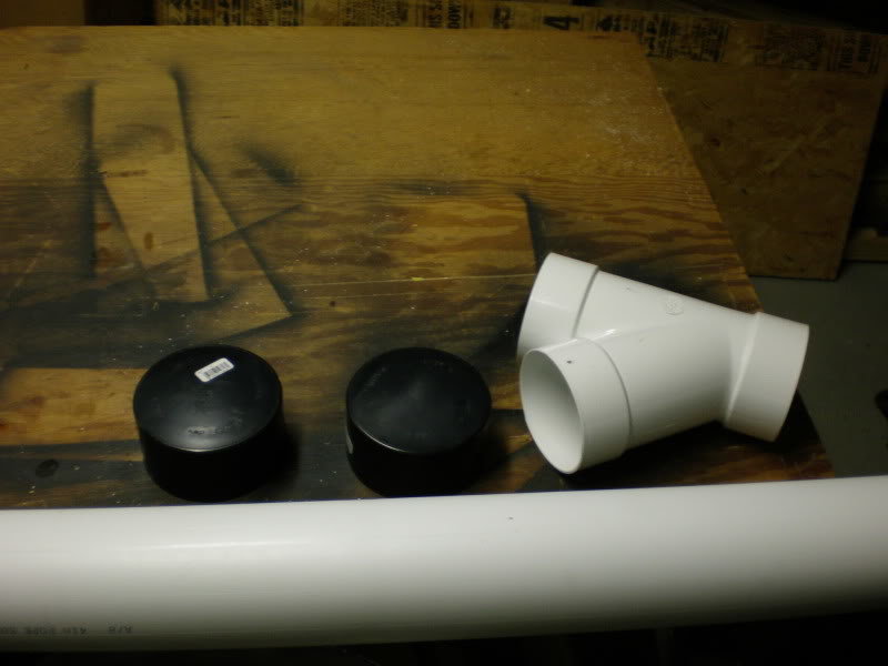

    Second, lay everything out and find out what your dealing with. You should have two(2) black 4" caps, one(1)4" wye, and a piece of 4" pipe cut to what ever length you desire. After I cut the flared end off, I had 9'8" to deal with. I made one 5', and the other one is about 2" shorter.

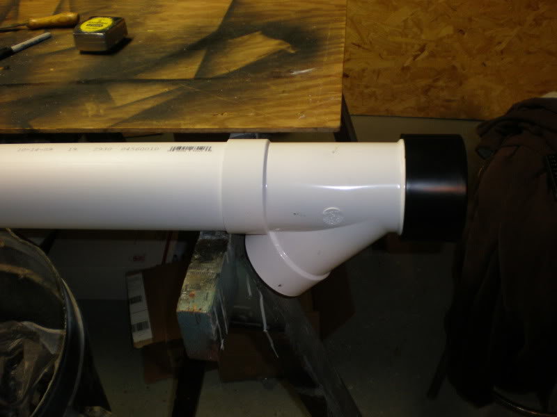

    Take the wye, and slide it onto one end of the 4" pipe you just cut like so011-5_2503529fc1bc8722402befba7481193f0e312765.jpg
    Pre-drill 4-5 small holes, and I used about 4-5 screws to hold it togehter. 6x3/4 is what I used to hold the wye onto the pipe.
