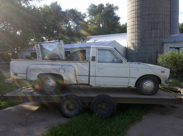

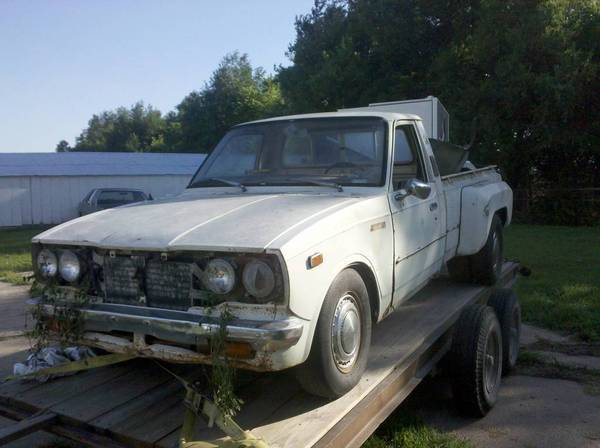

    I dig it. Gotta love all the people in here that think that 2.7L engine can't handle a load. How much power you think the 20R in my old Hilux made? This thing hauled horse trailers farm equipment just fine. Plus payload wise it packed enough dirt/hay to make the back of my Tacoma look like a dog dragging it's ass on the carpet (and yes I have the TSB). These are the last pictures I took before taking it to the scrap heap. The motor still fired but I had no use for it anymore and the electrics more or less needed a total replacement. 321,690 miles isn't bad for my 'ol dually.

    Neat old truck I think they called the old ones a Super Hilux. UHaul rented them as a box truck for a long time.
