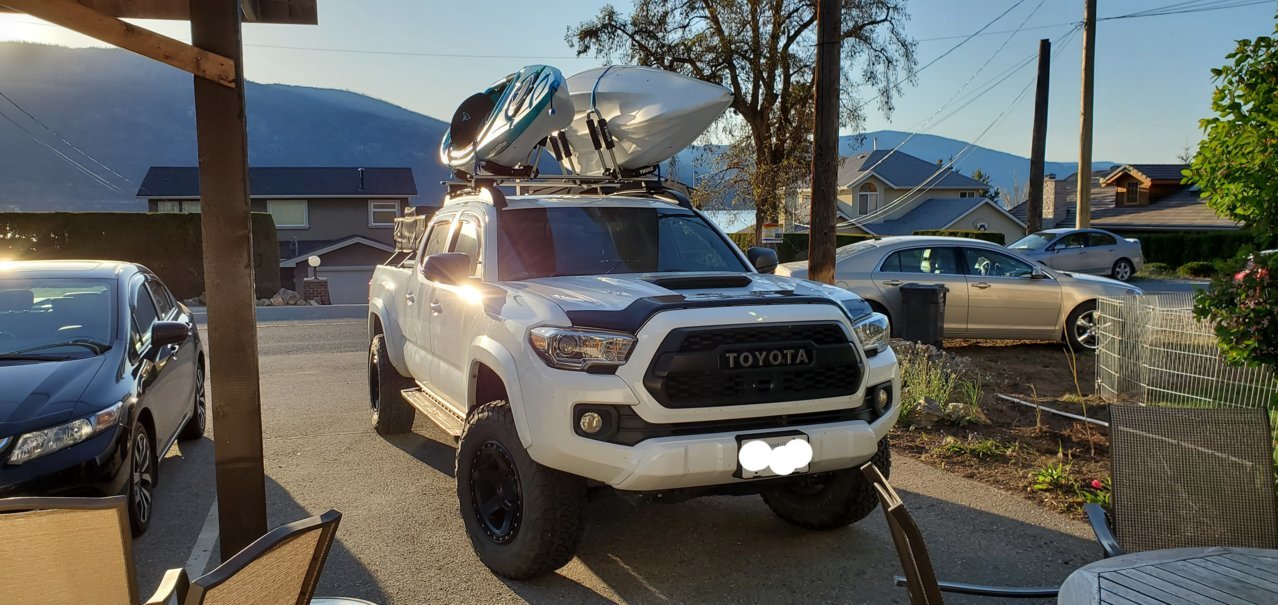

    I am running an Old Man Emu kit with dakars etc SPC uca's, 275/70/17 ko2s (almost a 33" lol) for about 2 years now. I no longer have any height restrictions in my life so I would love to lift it a bit more.
    I am looking at 6" lifts.
    I do have any access to plenty off roading. I do a lot of camping etc.
    Looking for performance but also something cost effective that will not break the bank.
    I am assuming I could keep my leafs and add a block? SPC's will still work?
    I had a local shop recommend a Procomp 6" lift.
