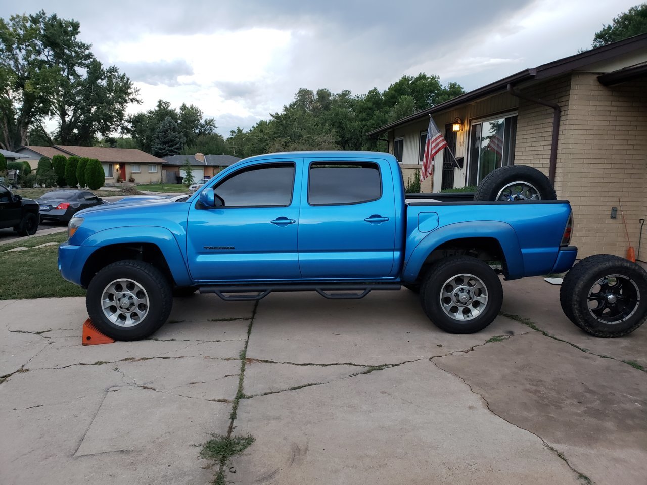

  10. Sep 7, 2018 at 11:34 AM
    TacomaAce42
    TacomaAce42 [OP] Member
    Sep 6, 2018
    #265457
    12
    Alan
    Marietta
    2006 white Tacoma SR5 Prerunner
    Lift 3” 33” Toyo M/Ts with XD addict wheels
  11. Sep 7, 2018 at 12:50 PM
    lynlan1819
    lynlan1819 Well-Known Member
    Mar 14, 2016
    #181268
    6,539
    Tacoma
    Lifted

  15. Sep 7, 2018 at 7:27 PM
    ColoTacoPrerunner06
    ColoTacoPrerunner06 Truck of my dreams
    Jul 22, 2018
    #260095
    281
    Speedway Blue 06 Prerunner built like I like it.
    5.5 lift front 4 rear on 33s with an endless amount more work to do
    My 06 pre has a deaver add a leak with 5100s and cst lift spindles and total chaos arms. I could easily go up another few inches by adding the lift kit you have... or one that won't destroy my truck. If you want to go up another 3-4 inches I would recommend doing a shackle flip and lift spindles. But before that get rid of the lift blocks and either put in add a leafs or an entire leaf pack.
