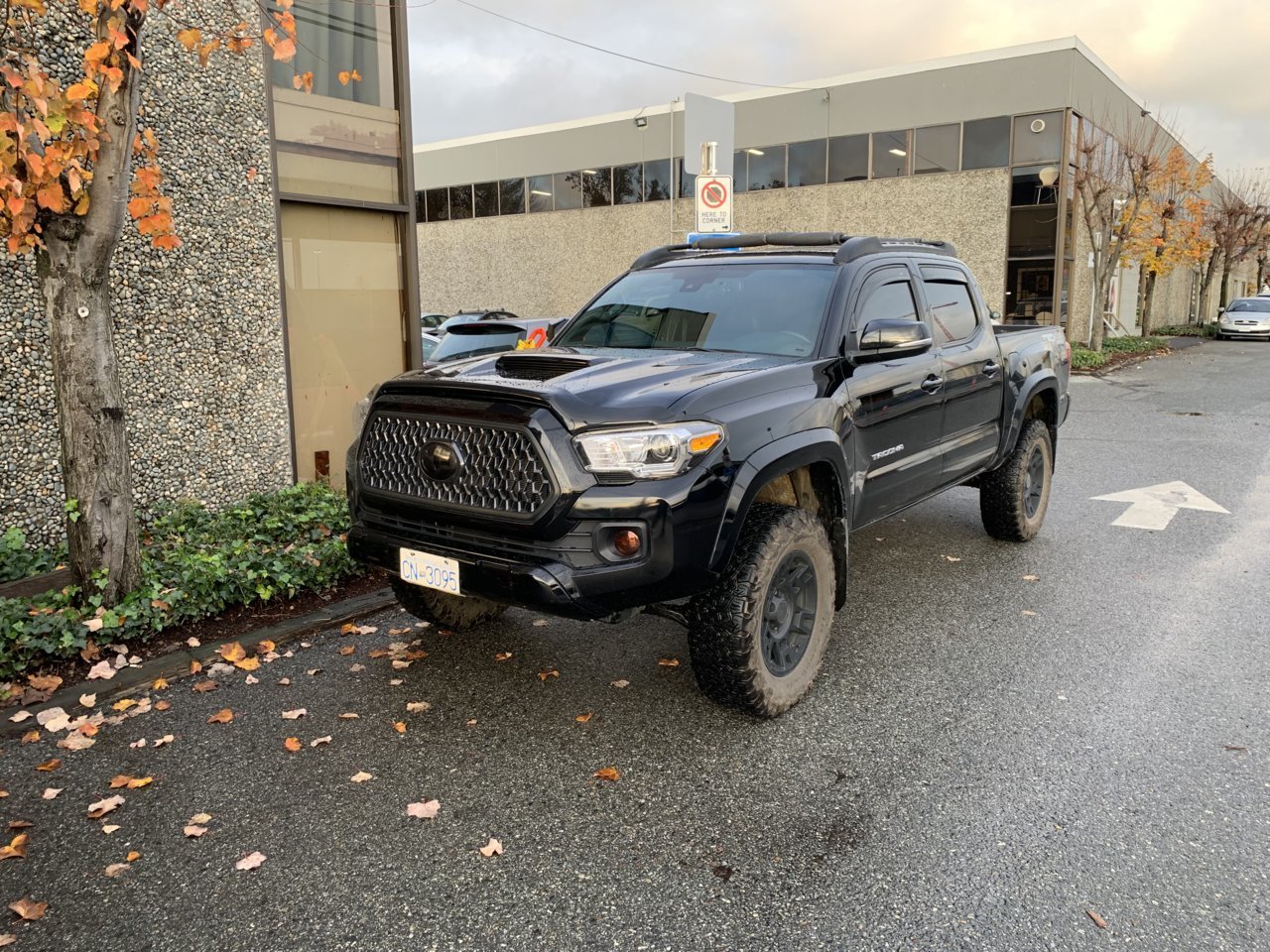

    I think something that gets messed up when people do the grille swap is they are doing other mods as well that adjust the rake/squat of their truck and that fucks with the TSS. Bad detection when passing a semi on the highway during a curve, it would detect the semi in my lane and press the brakes.
    I had about a 2" lift with a 1" squat on my truck and the TSS still worked, but it was very finnicky. Now that I'm back on a 2.5" lift with a 1.5" rake the TSS is back to acting like normal.
    So really if you do the install correctly and you have a rake instead of a squat you should be fine.

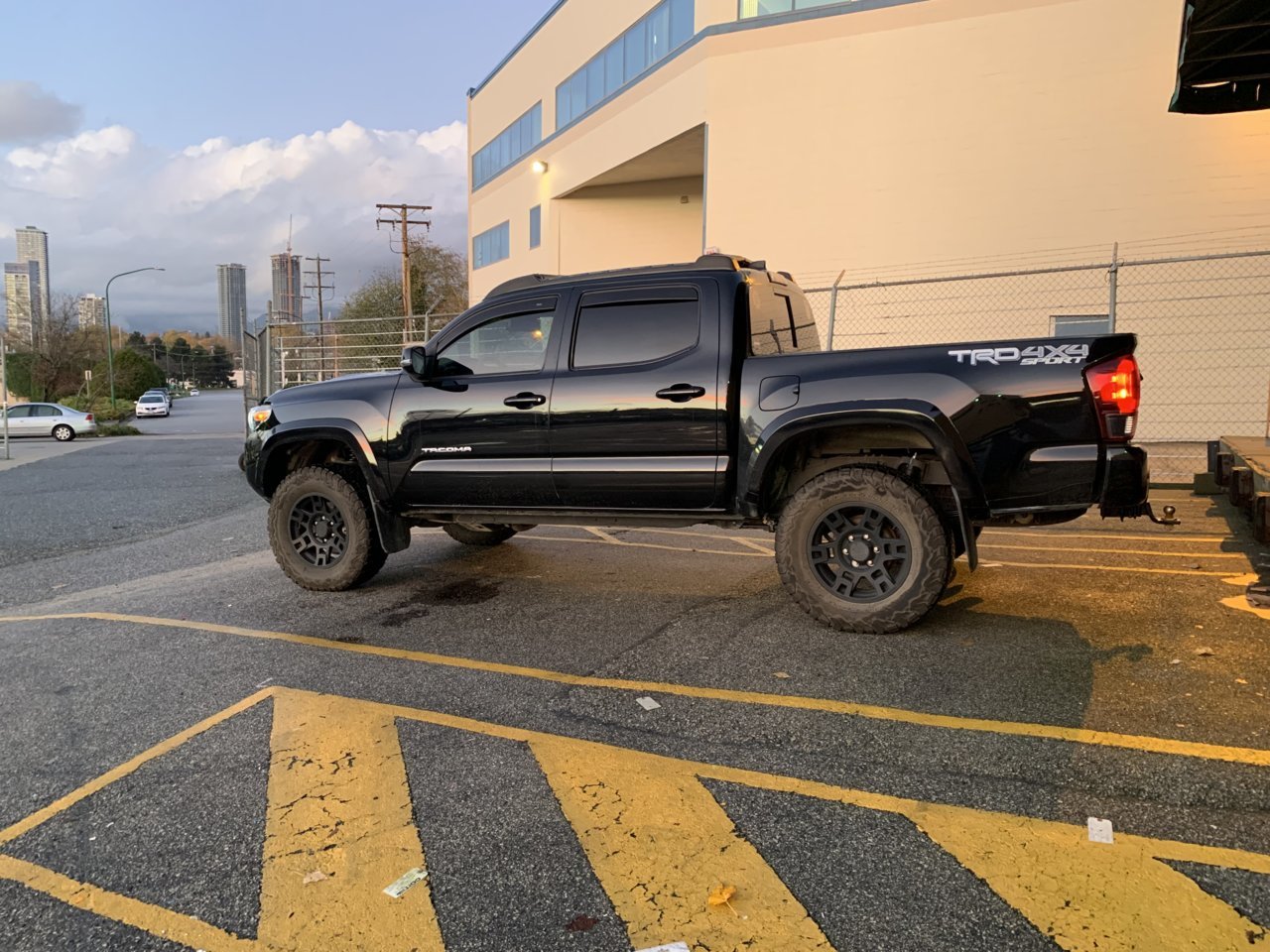

    I’m running OME front springs, OME nitro charger sport shocks and dobinsons rear leafs. 2” lift, I love it.
    Had it installed at a local off-road shop.
    I would avoid rough country.
