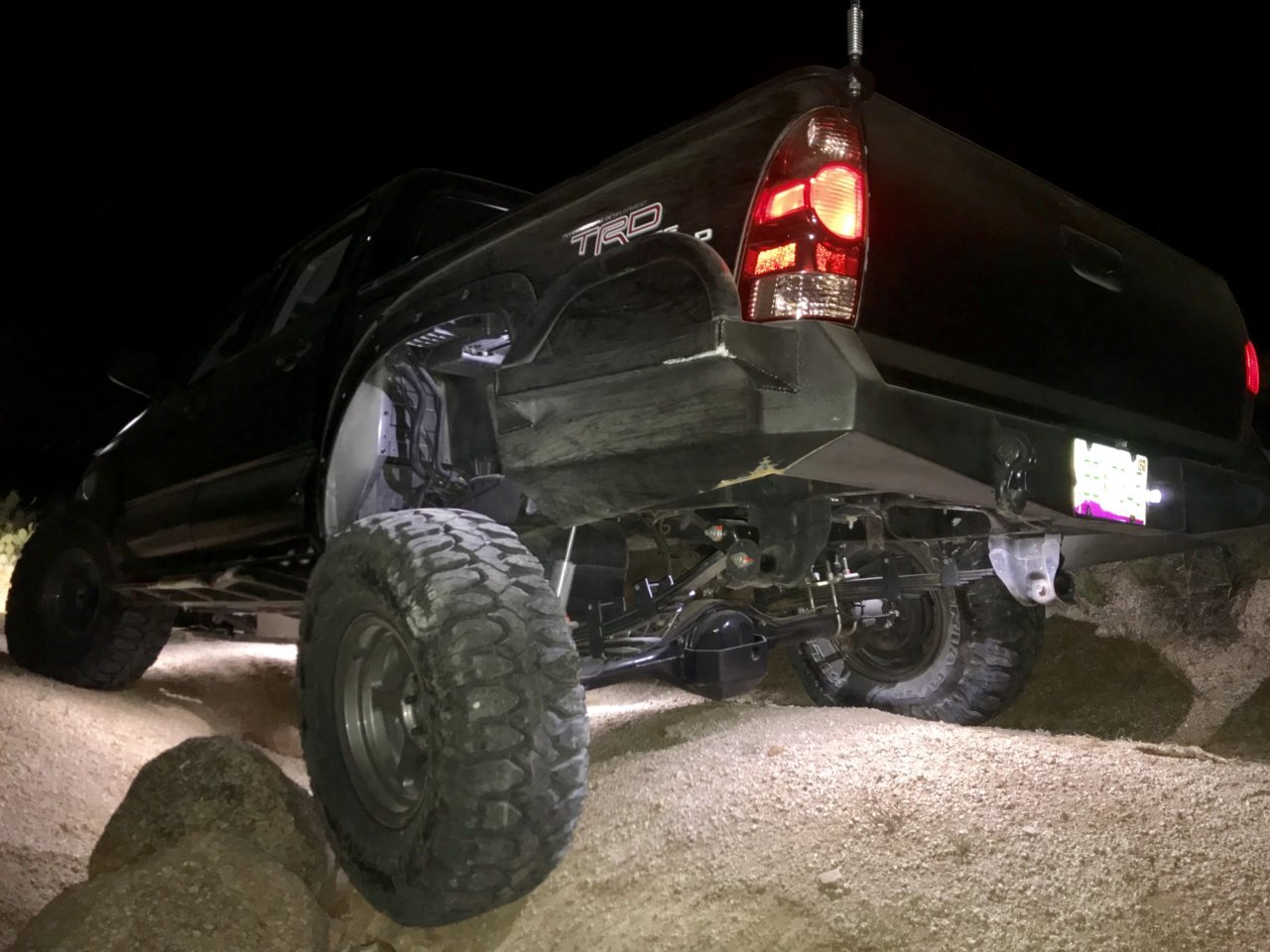

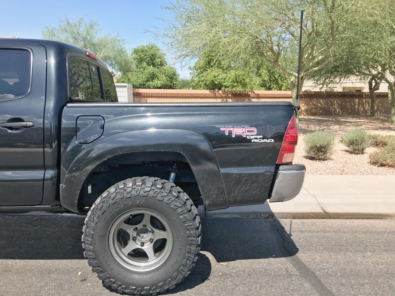

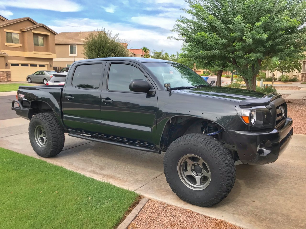

    The difference between a 33” tire on an 18” vs a 16” wheel is absolutely real. There is a significant difference in how flexible and pliable and elastic the tire will be. You obviously have realized how much LESS sidewall you’d have with an 18” wheel. Now just imagine airing down that tire for off road use... do you feel more comfortable doing that with a small sidewall? You will likely hit the rim with hard hits while aired down. If you had a 16” or 17” wheel you’ll have way more “cushion for the Pushin” & your on road and off road ride will be softer and more comfortable, as well as less likely to damage the wheels. You will also save money buying 16” or 17” tires as most in that size are cheaper than the 18” counterpart. I stuck with 16’s because I wanted the most TIRE possible.
    Remember, tires make the bigger difference in on and off road performance/handling/traction/stability etc. so if you choose an 18” wheel you’re sacrificing an amount of those in lieu of just “having bigger rims”
    Edit, I’ll show you when I first bought my truck it had 33’s on 18’s and I put 33’s on 16’s as fast as possible. Then I put 35’s on 16’s. I’m very happy with those choices and I would NEVER trade more “wheel” for less “tire” unless it was for some specific brake upgrade reason but even then I’d never run larger than a 17” wheel if the tires were up to 40” tall
