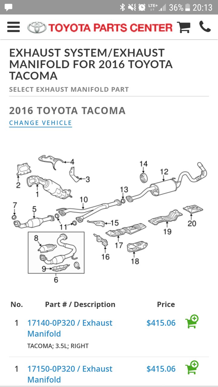

    The truck comes stock with an exhaust manifold. The left three cylinders and the right three cylinders each dump into a pipe that runs along them lengthwise, and then are fed into the rest of the exhaust. In this setup, the exhaust from the forward most cylinder must travel a longer distance then the other cylinders to reach the exhaust. In a header, each cylinder gets its own exhaust pipe that are all equal length, and after traveling equal distances, meet up and join the rest of the exhaust

    Just curious... when you speak of exhaust manifolds, you're not referring to the 3rd gen V6 - are you?

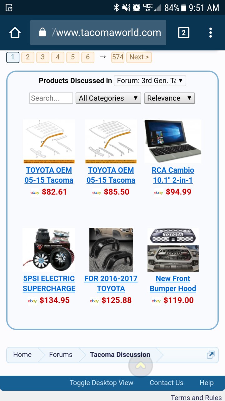

    Check out the adds at the bottom of the page, they have our answer. 5psi supercharger and it's only $135.

    You have an exhaust manifold. You do not have headers.

    They must be hidden then.. inside the heads.

    It's still a manifold. All three dump into one pipe/CAT with no regard for length of travel of the gases from one cylinder to another.
