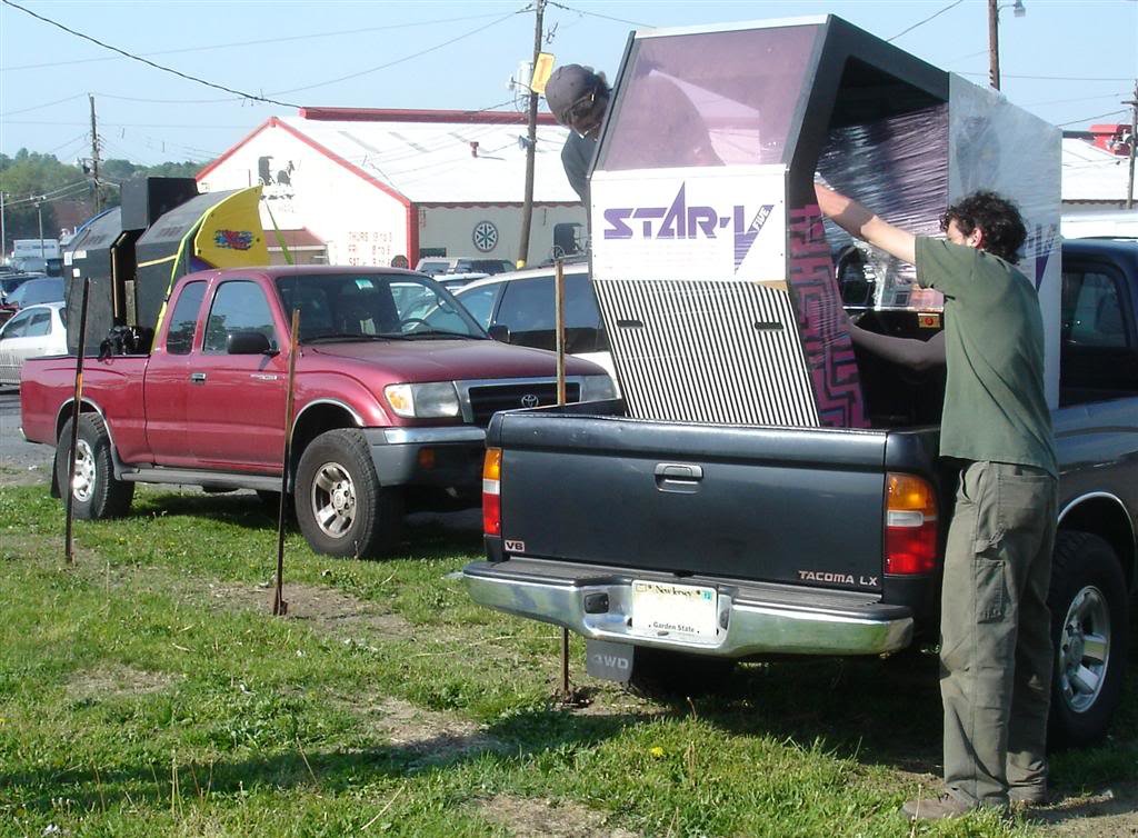

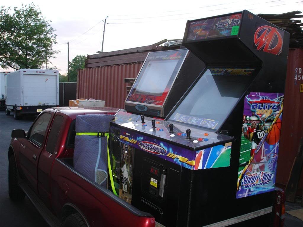

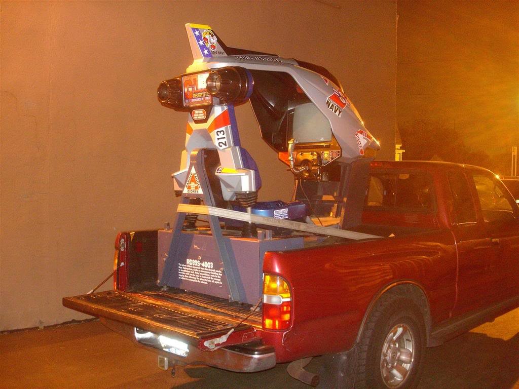

    I recently bought an '06 to replace the '99 with 271k miles that Toyota bought back from me.. and while I'm impressed that nearly everything is improved, I don't believe the bed rail system will meet my needs.. I regularly move arcade machines which tend to have a high center of gravity and need to be strapped in as tight as possible. A 3" strap pulled taut would hold in damn near anything, I'd rip the rails off if I tried that on the new truck, and the D-hooks at the back of the bed don't seem that strong either..
    Has anybody added in hooks in the place they were found on the 1gen trucks? the placement was ideal for what I need. Anything aftermarket available or any other good solutions?

    Obviously, my first thought was the D-rings.. but even at 800 lbs WL I'd probably stress them too much with a 3" strap and they would be the weak link. They'd probably work fine for most things, but I can't chance it and I need something heavier than that..
    I want the get the TSB done, but I'm under the impression it has to be under warranty for that? I'm at 55k miles so I'm still under powertrain, but not B-to-B. Any idea on cost outside of warranty?
    On the old taco I cracked leaf springs twice.. I went with heavier springs after the first time and one still cracked a year later.. a normal load isn't any more than 600lbs or so usually, but every now and then I'll get something like that first pic above, that game weighs about 1k lbs.
