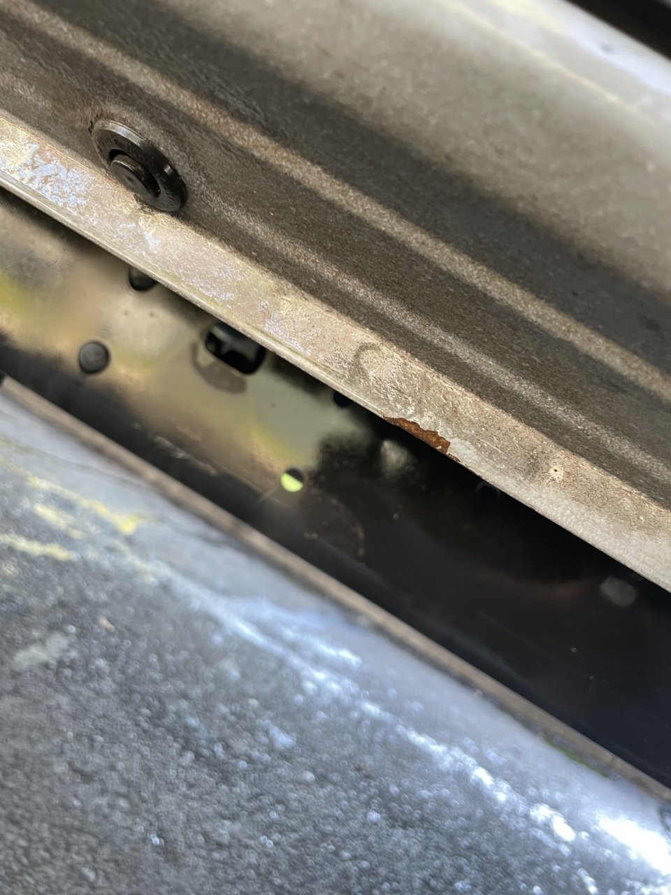

    What’s an easier way to fix this ?

    looks like its not where its easily seen
    grind down to bare metal..............use BEST primer !!
    repaint with nearest match

    Not what you want to see, especially what appears to be more oxidation around the rubber plug. Subjected to road salt ~6 months a year here and it's a constant battle. If you plan on keeping it for any length of time recommend a complete in-depth vehicle inspection to identify and aggressively treat corrosion/rust followed by period inspections/treatment.
    Edit: That said, hope it's minor and an easy fix for you.
