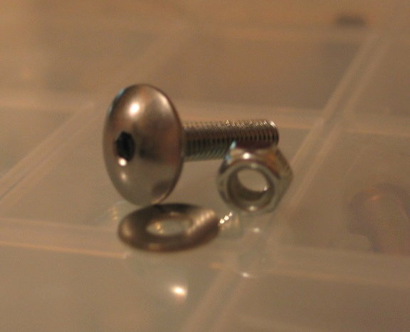

    I just put the tag on my two week old SR5 and noticed the bolts screw into soft plastic only. A kid with a dull butter knife could unscrew them. Security bolts wouldn't be of much good either if they can't be snugged down. Anyone have a tip on how to mount the tag to help prevent theft? I've had one taken before and it's no fun.

    I drilled out the screw holes in the plastic ever so slightly and ran some 4mm hex drive, M6X1.0 button-head bolts through the tag, plastic and the existing hole in the steel behind the plastic. The black plastic rests about 5-6mm off the support steel in those spots. So, I made some spacers out of a stack of washers. To secure the bolts, I used ordinary M6X1.0 nuts with nylon inserts. It was a bit of a yoga move to hold them in place while running the tag bolts through. The tag's now nice and secure, though. Heck, short of destroying the tag, I'd wager a thief would be baffled as to how to get the bolts out.
    :D
    Once they are turned maybe 1/2 a turn, the whole thing's going to just spin in place unless a wrench is put on the nuts back there and it ain't going to be easy! LOL

    One could glue the plastic screws in place. But, they really don't have a lot of material to grab onto. The plastic bumper cover's is maybe 3/16" thick.
    That only amounts to about 2-3 threads' worth. It'd be really easy to strip 'em out.
    The M6X1.0 bolts I used are stainless steel ones I had leftover from a Yamaha project where I ordered more than I needed, luckily. =)
