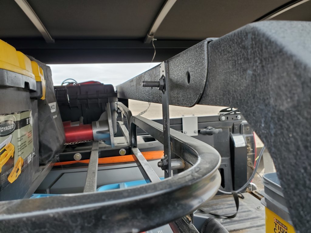

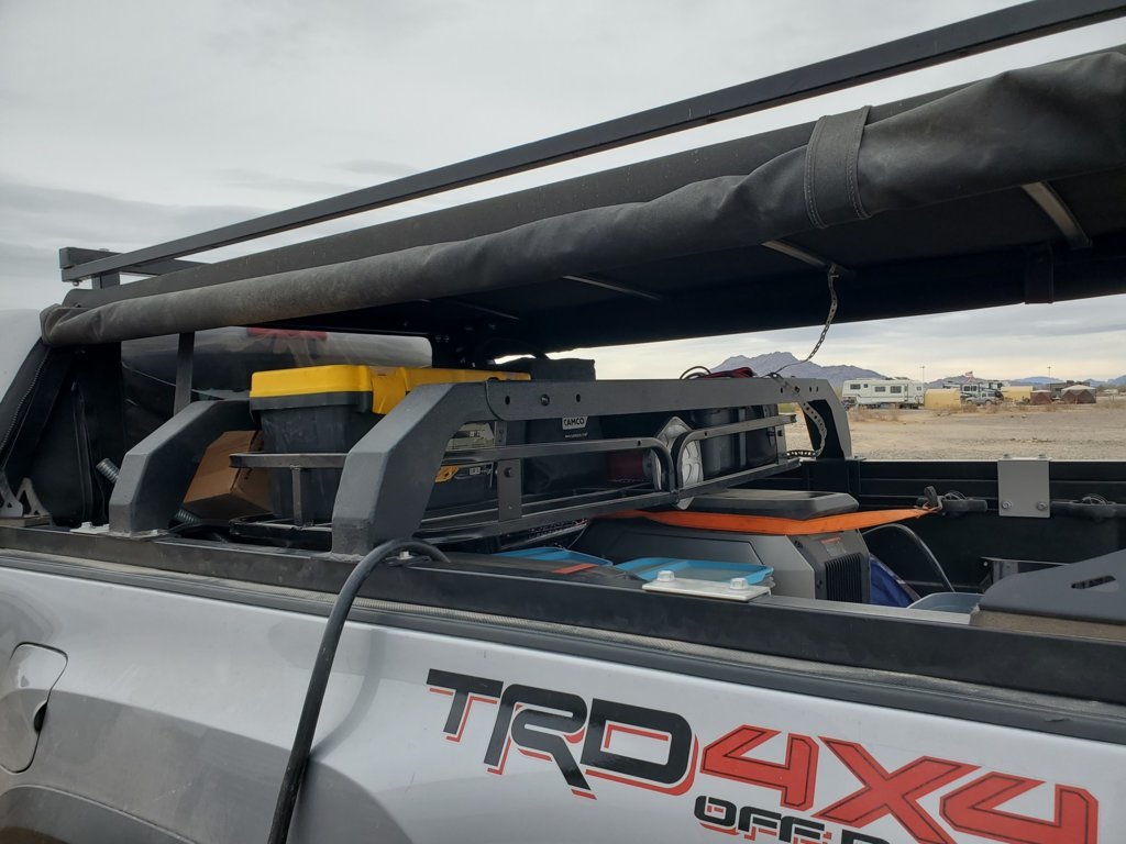

    I bought on Amazon - Truck Bed Rack with 2 Cross Bars, and a Maxxhaul trailer hitch cargo carrier to make room for more stuff.
    The hitch carrier I assembled without the hitch tube. The straps that hang the carrier came with the rails. I used round aluminum stock for lower spacers.
    The load rated soft topper is from Wildtops in Australia.
    Without the topper, the rails can be mounted to the bed cargo rails. I had to drill into the soft topper frame to mount the rails.
    I had a solar panel mounted to the soft topper, on the bars I added that go front to back. Got rid that solar, now use folding panels that I can move around.
