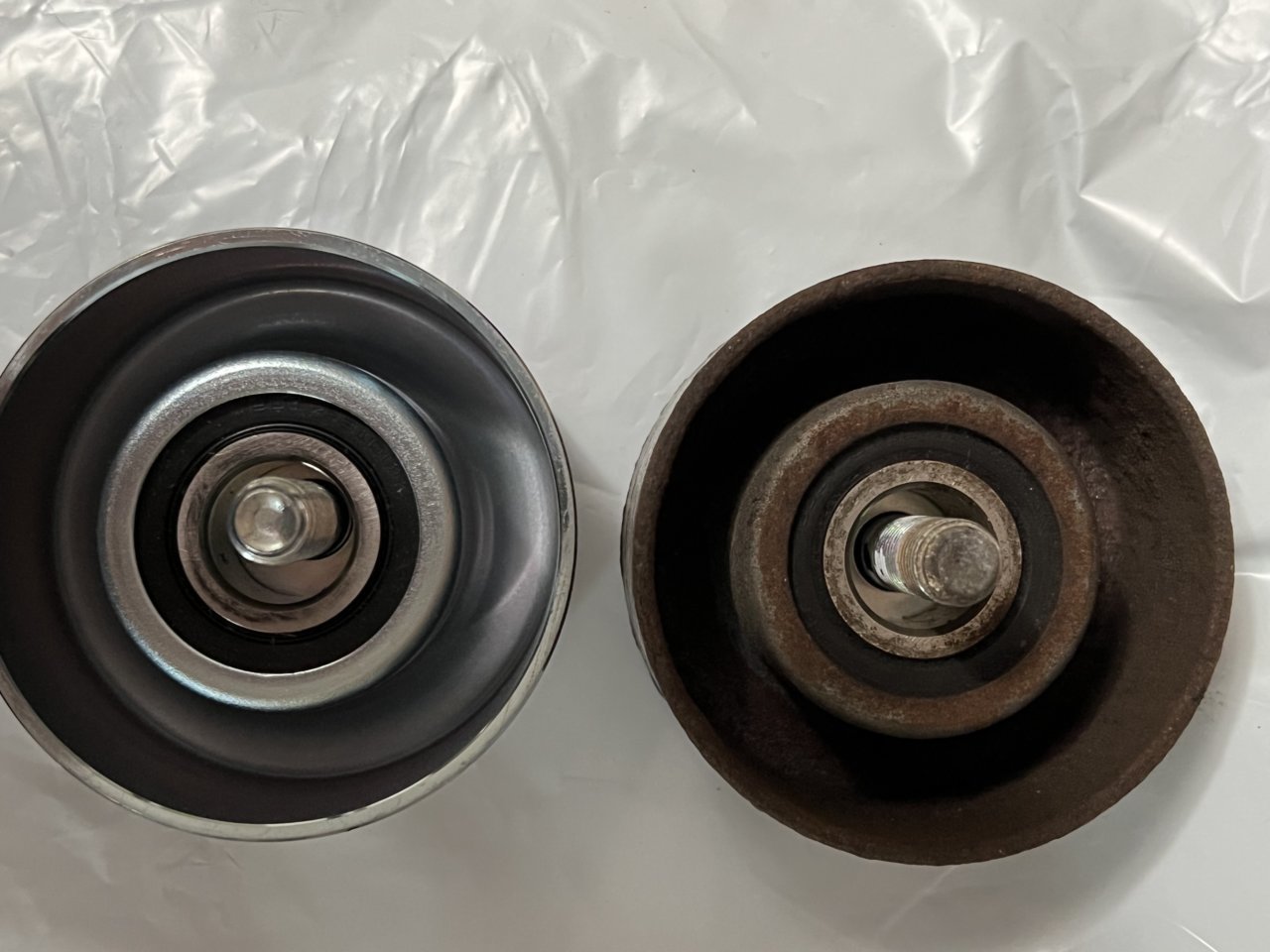

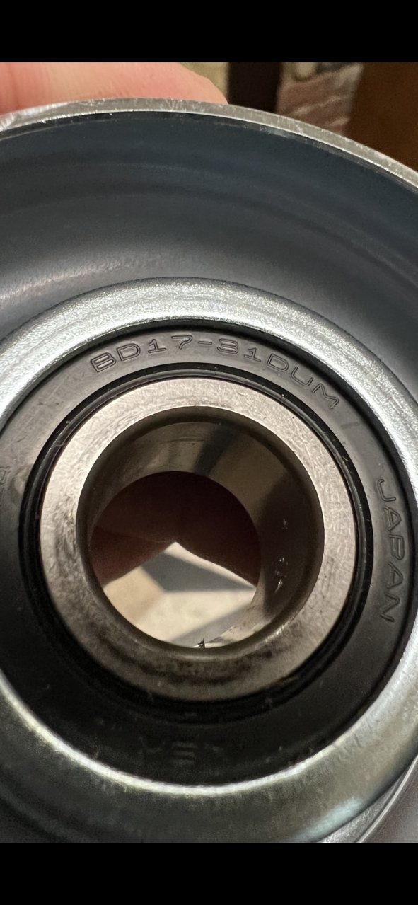

    Hey guys, I just ordered Continental 49416 Accu-Drive Tensioner Assembly from Amazon warehouse for $35. The idler pulley is the exact same one as my original OEM.
    I did email continental to see if they would consider offering the idler pulley separate from the tensioner, I will update here when I receive a response.
    I will verify if the entire tensioner assembly is exactly the same as OEM when I tear it apart but from what I could tell, it appears to be.

    Not necessarily, the pulley spins constantly.
    The wear to the pulley is usually the ball bearings and pulley surface itself.
    Where as tensioner is just a constant pressure. Yes, ideally you would replace the whole unit.
    However, on the 4.0 it is quite a job. You need to remove the Alternator and A/C compressor.
    So, for us “lazy” folks. We would rather remove 1 bolt and replace it.
    You can “usually” get an idea how bad the tensioner spring is. “Usually”
